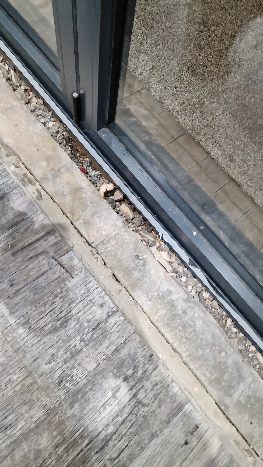

We had a window changed to a bifold door and unsure how to fill the gap in the what was cavity , under the rubble is sand and it seems to stop about 12 inches down, do I need to put a plastic
membrane down too?
membrane down too?
Form a U shaped trough with damp proof membrane and fill with concrete.
bear in mind that creates a cold bridge, but then if your house floor isn’t insulated, it makes no difference
