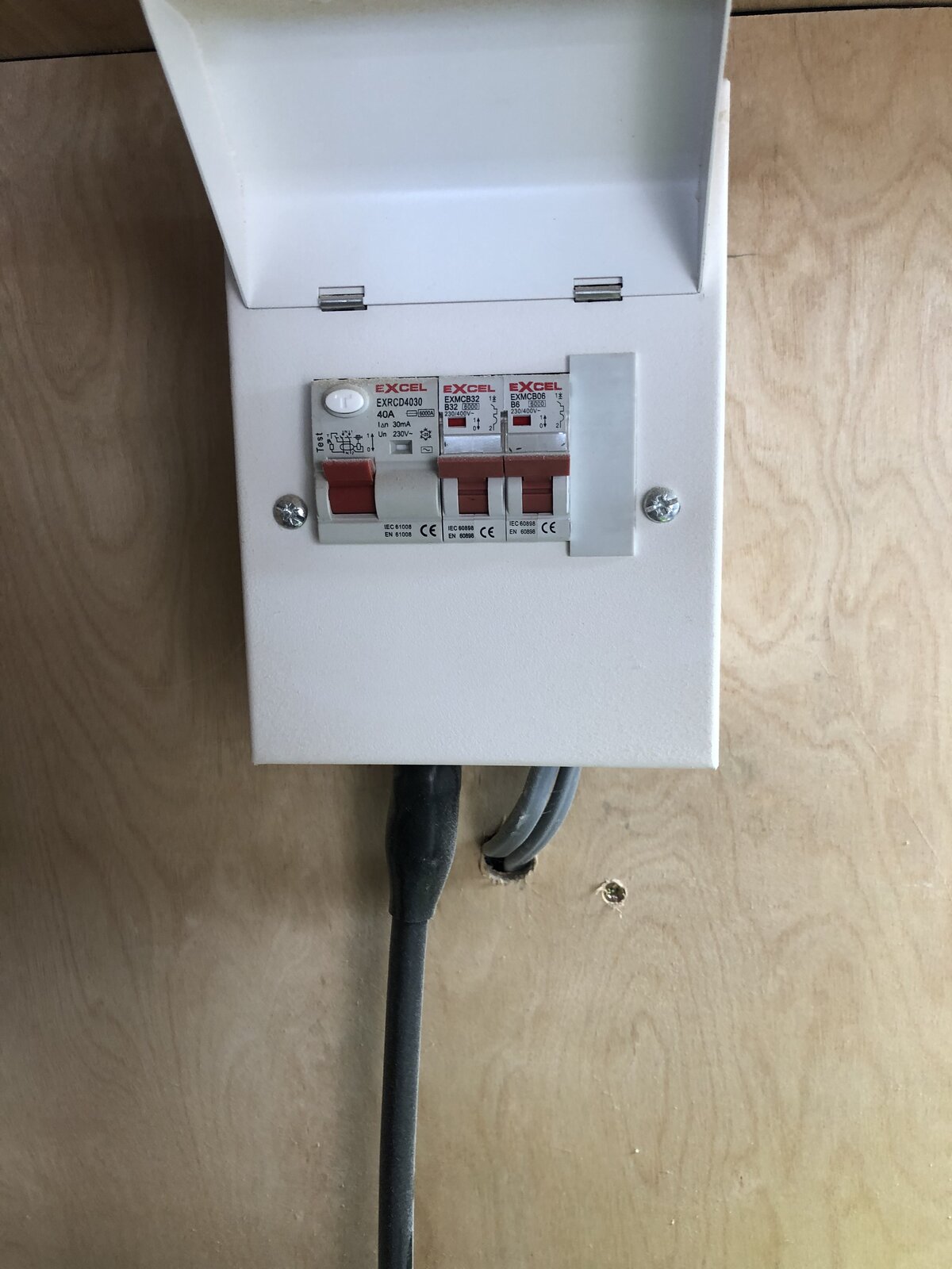

I already have a small workshop that is wired to the main consumer unit in the house. In the small workshop I have consumer unit and it runs lighting and sockets for power tools, pillar drill, table saw etc.
Now I am building a larger workshop down the bottom of the garden and will need to power this from the small workshop near the house, I did the main wiring myself and run armoured cable to small workshop and then got a sparky to wire to consumer units and certify and issue certificate.
So I need to know:
  1. What consumer unit do I need to replace the one in small workshop so I can run armoured cable down to large workshop.
  2. What armoured cable do I need.
  3. Can I take consumer unit from small to large workshop, or should I just buy new
To clarify: House (consumer unit) to Small Workshop (consumer unit), Small Workshop (consumer unit) to Large workshop (consumer unit).
Have attached photos of current consumer units.
I will be buying form https://www.cef.co.uk/ or https://www.tlc-direct.co.uk/
Also looking for a sparky that can wire this and issue test certificate, I'm in Cambridge (CB25 area)

What are you planning to run in you workshop(s)?

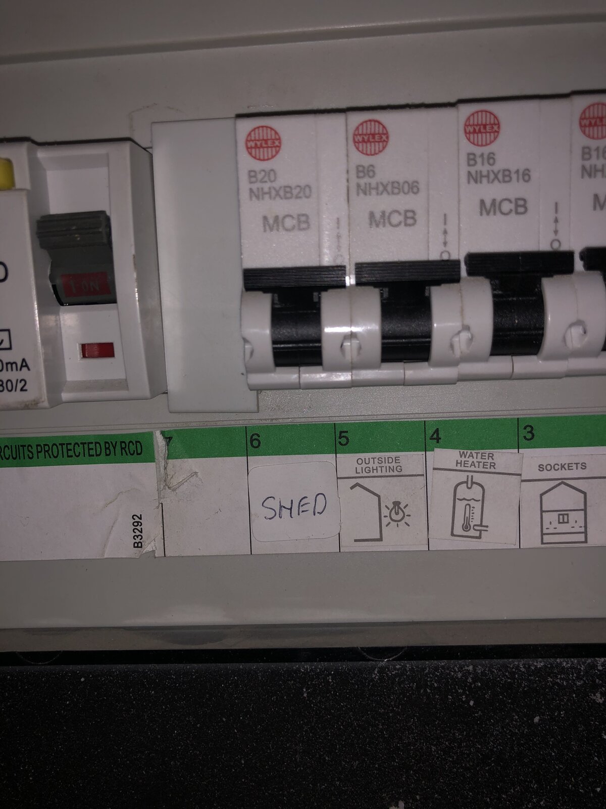

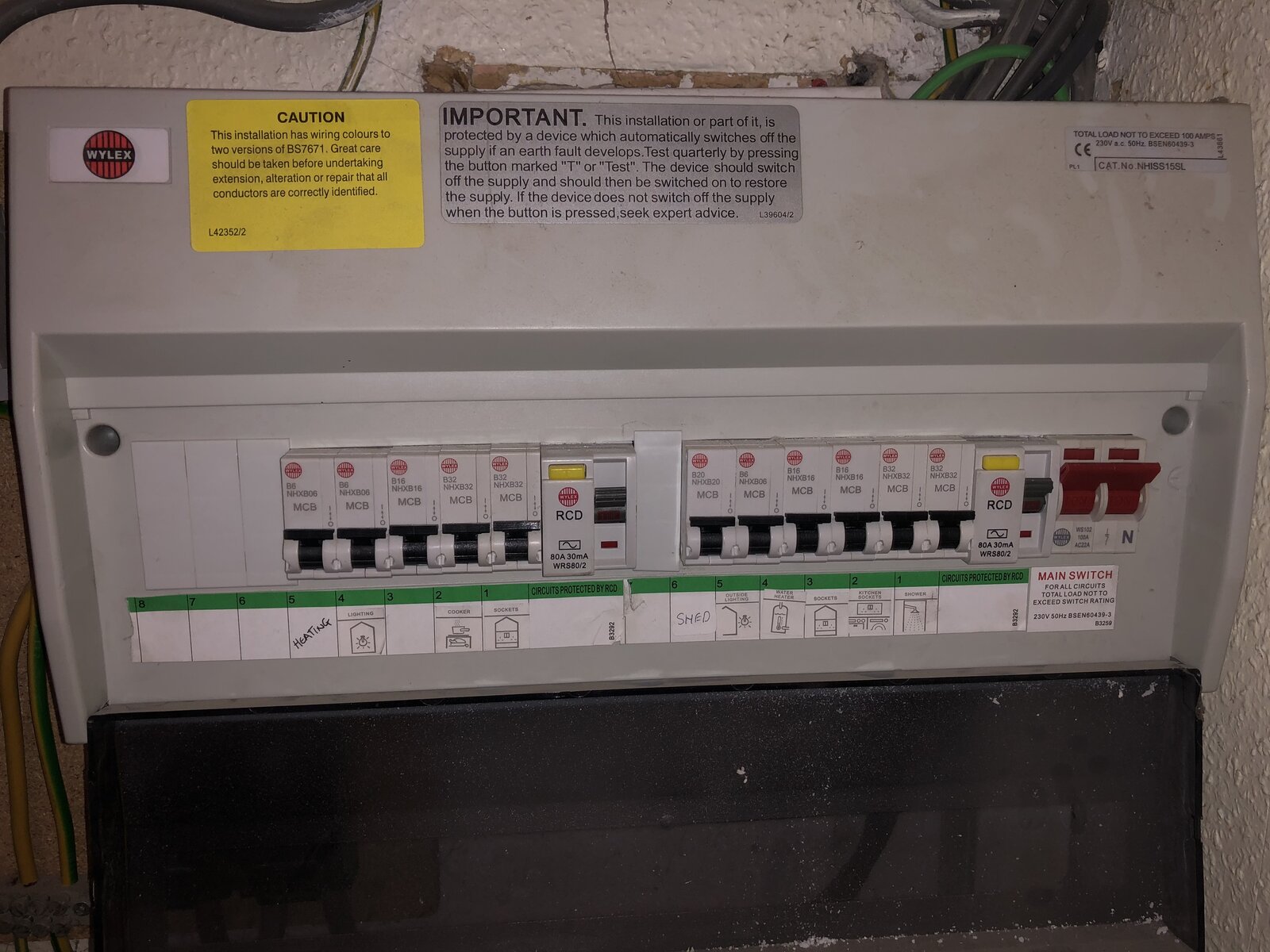

The feed from the house is 20amp, is that going to be enough?, If not, you'll need a big rethink.

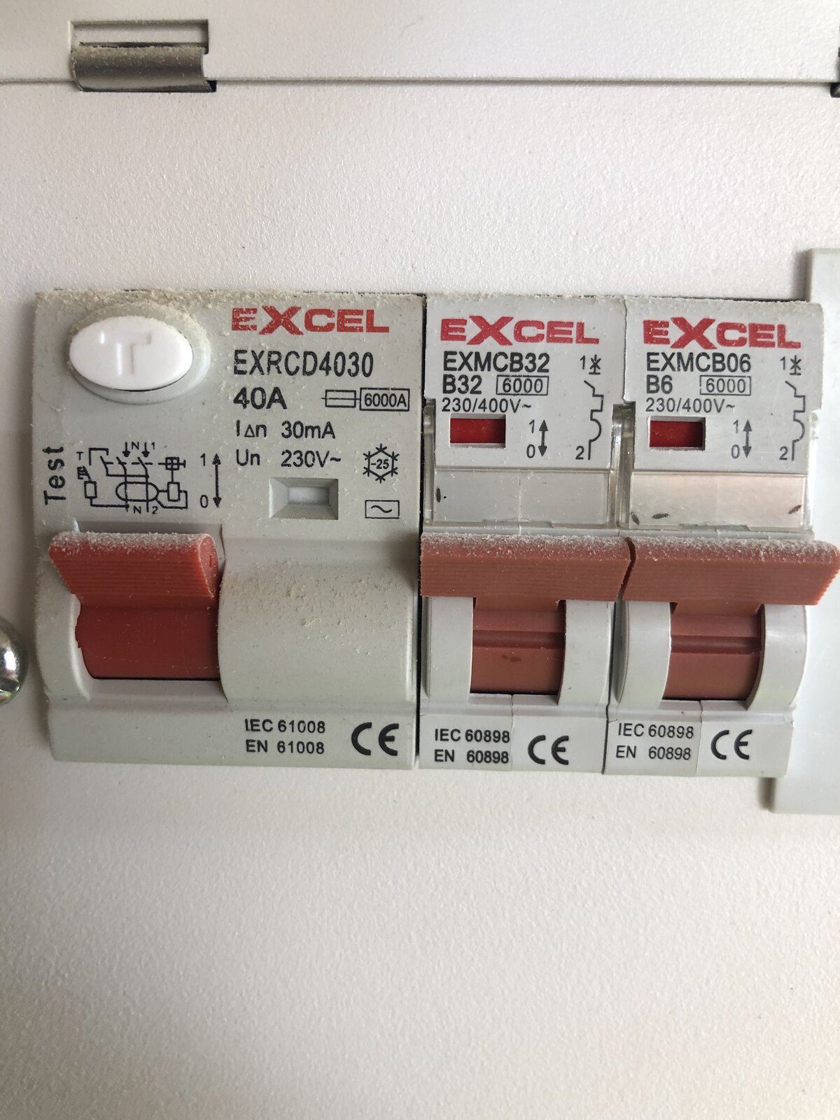

Second comment is that there is absolutely no point in having a circuit in workshop1 fused at 32amp, that can never ever in a million years do anything. The current can never be more than 20amp!
Third. You have an RCD in that quality Excel board, what is the point of that? the circuit in the house is already RCD-protected! A fault in any of your workshops may trip the house RCD, probably defrosting the freezer (on the kitchen sockets circuit). That also needs rethink.
Suggest you get an electrician now to advise and sort out the basic stuff.
As Taylor has mentioned, your existing setup is very badly designed and really needs to be properly rethought before you go any further.
The existing supply to your outbuilding is very small and won’t really power much more than a couple of lights and a socket. There is no point having a consumer unit at all at the moment.
What exactly are you planning on running in your two buildings? How long are the cable runs from the house to building one, and building one to building two?
You mentioned you have a table saw. What type of lights do you have / plan to have in your buildings?
Ditto above - what size Armour is that going into the Shed at present 2.5mm ?

As a quick overview of the job I would:-
-Change the 20A Wylex MCB for a 20A RCBO fed from a non-RCD terminal in the main board.
-I wouldn't worry about discrimination between RCD's once the garage circuit is separated from the RCD in the main board.
-Reduce the 32A MCB in garage board to a 20A MCB (possibly EXMB20).
-Do a cable calc for the entire run to the large workshop to include both lengths, probably to find that 2.5mm, 4mm or even 6mm SWA will do the job depending on distance.
-Then either run another garage board with 20 & 6A breakers, or just run the SWA in to a metal clad FCU and fuse it down for the lights depending on wether or not you want the option to isolate the power to the large workshop or not.
-Also would need to check for any extraneous metalwork in both outbuilding to make sure the earthing and any bonding that may be required is adequate.

Any changing of anything hangs on that decision. The MCB at the house end will probably need to be bigger and that may negate changes to the downstream devices as a result
- but note that achieving discrimination between MCBs is very difficult unless there is at least a 2:1 ration between their trip characteristics. Thats why a fuse at the source end is preferred.
re
I agree that the CPD for the feed should not put the rest of the house at risk. But it is an MCB in a non-RCD way that is required(or better a fuse carrier in the CU).
It is SWA all the way and does not require an RCD. There's an RCD in shed1, and that can provide protection for both outbuildings.

Re my suggestion of feeding from the main board via an RCBO. I am more of a belt & braces kind of guy. This came in to play only last week when I got a call out to domestic garage tripping the RCD in the customers main board that it was fed from and disconnecting the power to that half of the board. It was SWA all the way from the MCB to a garage board. Testing with both ends disconnected revealed low IR between L-E, but as half of the run had been built on by an extension I can only assume that it was damaged underground. If it was on it's own RCD then the they could have had a hot dinner the night before :D
