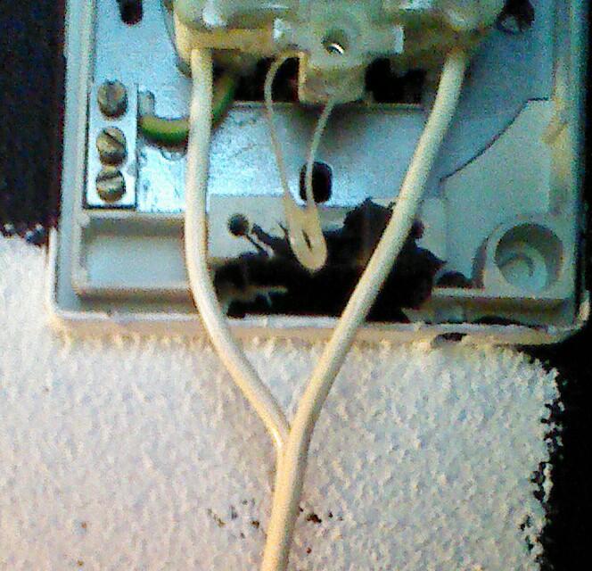

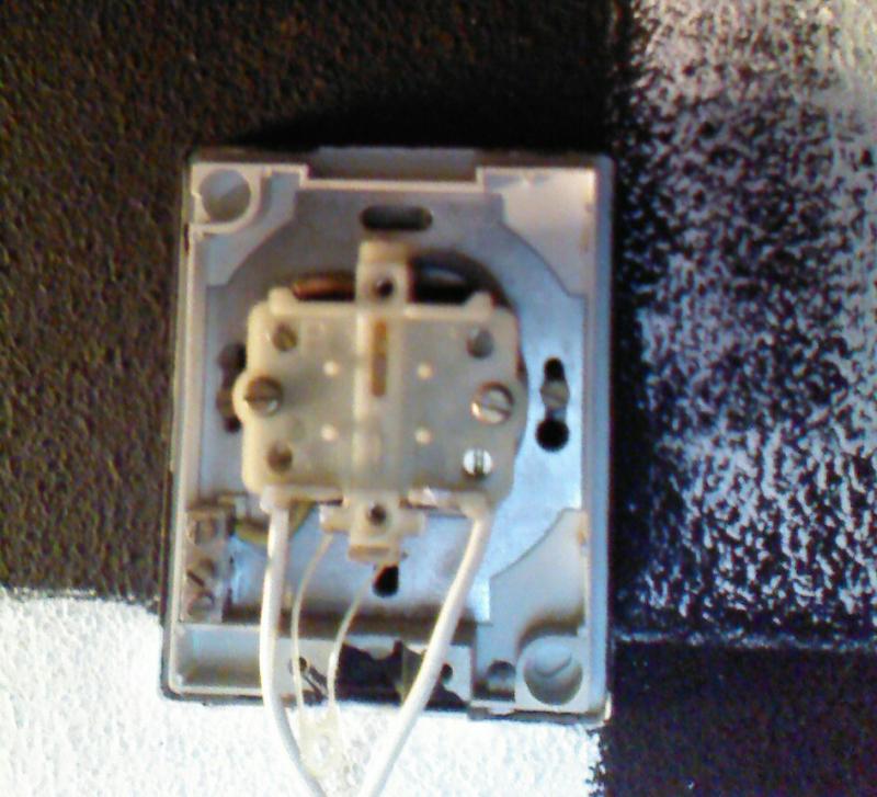

Hi, I'm staying with friends in an old house in the heart of Amsterdam and without going into a long story i'm thinking of wiring my UK extension lead into the point meant for the washing machine.
They didn't even know what it was for and I had to fix before they even knew it was live. I was happy to reattach wiring to where it obviously had come loose, but my experience of household wiring comes from the UK with my father and lots of books and diagrams as backup. The lack of earthing on plugs and on/off switches makes me a bit uneasy.
The box I want to wire into has a switch, and an earth (thankfully!) I have one of those 'electrical screwdrivers' which lights up on a live line so I can see which side is live, when the switch is off.
I've even tried a Dutch extension lead, wired in and actually run the washing machine and the hoover from it so I know it works, but I took that wiring out as a personally didn't like the lack of an earth wire.
What I'd like is just a bit of confirmation, about how to do this and if there's anything I'm not considering. I would wire the live wire into the point that is live, when it is switched off and the neutral into the other "dead" point. Now the earth point has three screw's, one has the earth wire in, are there two empty earth points to give the option to wire in two separate machines? (Washer and dryer? Which doesn't make sense as there's only one point to wire into, unless series wiring two devices into the same holes is considered normal in old dutch wiring?) So I can just wire my earth into either of the empty screws below the earth wire?
I've probably been as clear as mud. I've put two pictures below, with the two wire extension lead wired in. The white plastic inbetween is the switch, with the cord removed. Any help is much appreciated :) [GALLERY=media, 80023][/GALLERY] [GALLERY=media, 80024][/GALLERY]

You need to ensure your earth points actually go to earth before you do anything further.

I tested the earth with the old "bulb method" that i was shown years ago, an old electrician I used to work with showed me so I've always used it and thought it reliable? Unless I'm wrong?
Why are you wiring an extension lead into the fixed wiring ?
Can you not do the simple and sensible thing to do which is fit a Dutch plug onto the extension lead and then plug that into a socket.

This is the only power supply in this room, there are no other power outlets nearby. There was, 6 extension cords plugged into each other with numerous devices also plugged in, with no fuses or on/off switches to be seen. I got rid of all this because i thought it was unsafe. I thought a functioning, earthed, unused power point was an excellent alternative and also meant I could wire in my UK extension lead and take the converter out of the equation.
I posted this message in case somebody could point out any pitfalls with this idea.
Just to note, there is a fully safe cover that goes over the power point and the cord was removed for cleaning.
You can wire your earth into either of those screws as they both go to the same point.
