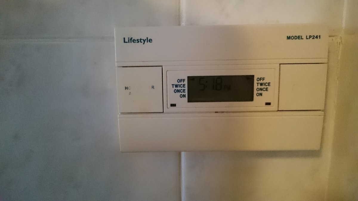

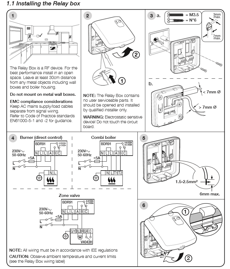

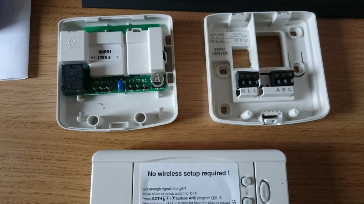

I can't get my head around this and I'm wondering if any of you can help me out. I currently have a Worcester Heatslave 15/19 Oil Boiler, it is controlled with a Programmer in the Kitchen, where I can tell both the Hot Water and Heating to come on, and set times for weekdays and weekends. Strangely, there's also a ETS 1 Lifestyle Thermostat in the Boiler room. (not the best location) I have bought a Center Wireless thermostat in order to better manage my heating and to hopefully save some Oil. I want to keep the programmer in the Kitchen as it also controls the water.The RF unit (BDR91) needs to be installed near to the boiler. I Imagined the Wiring would simply replace the current thermostat but it doesn't look so easy. Will upload several pictures to illustrate. Can anyone help with my wiring? Is it possible?
Edit: After taking a look at PCB for the Boiler, the thermostat next to the boiler turns out to be a Frost stat with the wrong facia - I'm guessing the previous owner wanted to use up supplies! Ideally, I'd like to keep it there.

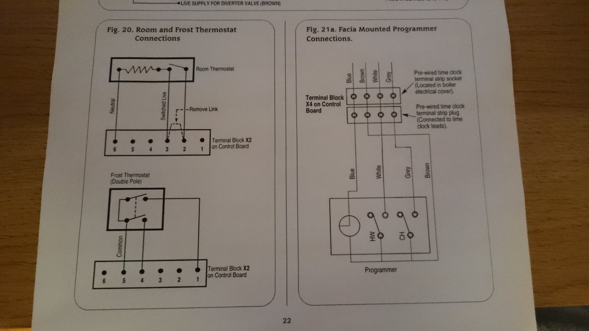

So, the current situation is as follows, My Kitchen 7day programmer currently calls for heat and water when I press a button or during certain times during the day. I have a Programmable Thermostat that I would like to use in order to be more efficient and have better control.
Is It possible to use both programmers? I need the kitchen one in order to call for Hot Water. The Heating would I guess be left on constant, but the actual say would come from the programmable thermostat as to whether it is on or not.
If so, how would the wiring work look? I've uploaded the boiler diagram and that of the programmable thermostat.
