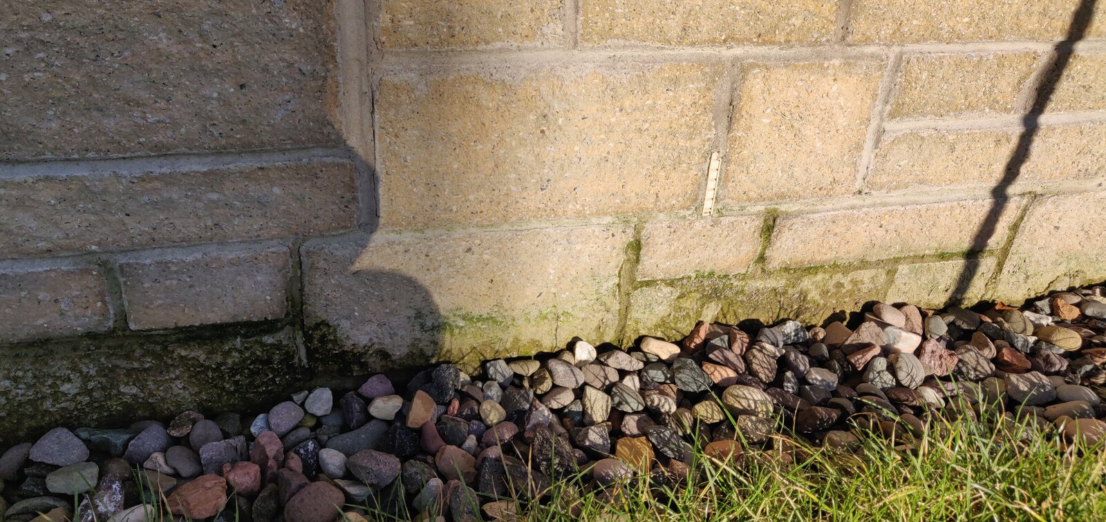

Hi All - first post on here, so hope I'm in the right place.

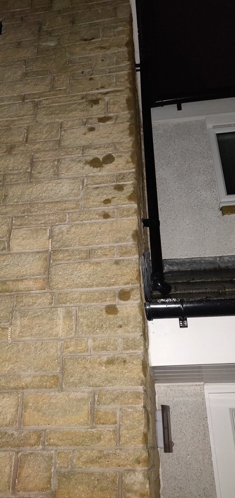

I think I have a few issues with my external brickwork. I've been back to the contractor a few times on possible damp issues (see pics with damp line/green moss along bottom of brickwork), but I'm also seeing issues with white staining from the mortar. The new one tonight is I'm seeing some very random wet spot circle dot patterns on the brickwork.
Anyone seen any of these before and know if I should be worried?

The green patch on the bottom pic is below the DPC which is designed to be wet so no worries there.

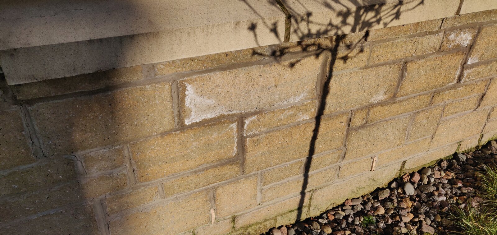

above it the white staining is what’s called efflorescence which is a build up of salts releasing from a wet brick. Also no cause for concern.
And an educated guess as to why your corner is wet would have me looking at the join between the gutter and the rain water pipe. Might not be but that’s where I’d look first
Hey - yeah, spot on. Scotland and timber frame. Persimmon build, which we've not had a lot of success with so far

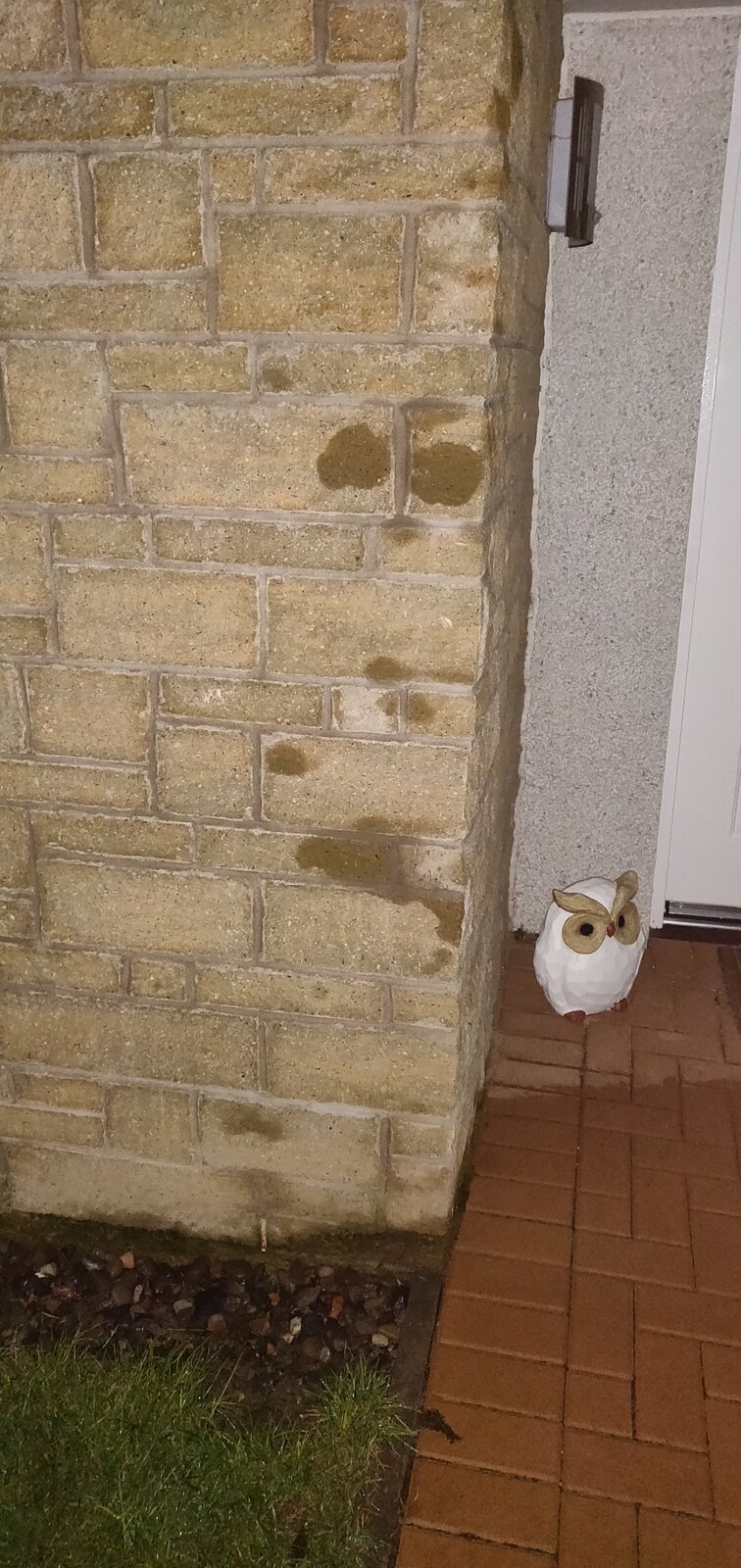

For the corners, it was more the random circle patches I was worried about. Seemed a very odd pattern that I'd not seen before....
Was the other side of that corner soaked, of does it have the patches too? It looks like it gets driven rain
For the efflorescence under the window cill, check that the cill as a proper drip detail (groove) to allow water to drip off the wall not down it. Also check cill joints to make sure rain is not going through the joints - it looks like it is
The damp up and down the side was rain. It was more the circle patches which is never seen before. Was worried this me be something coming from the inside out...?
There is a drip under the cill, but the wall under the window after rain is usually soaked. Would that possibly mean the cill has been set too close or too far away from the wall?
