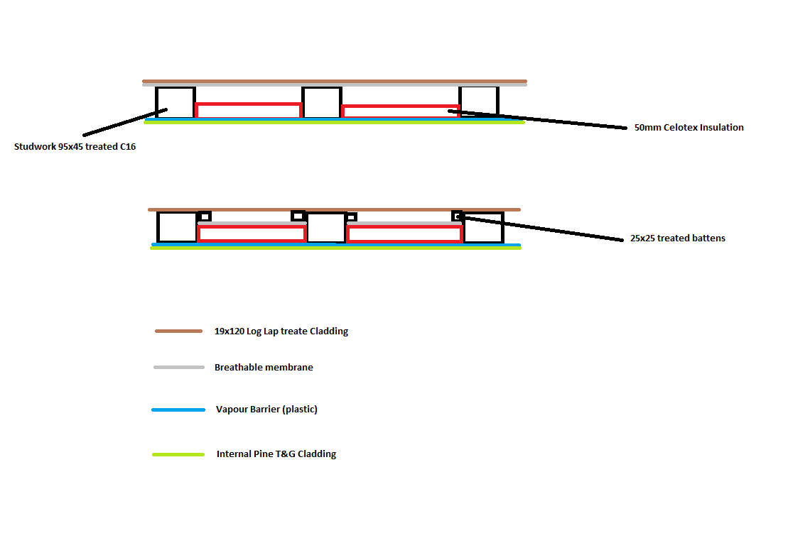

Ok so I am in the process of building a 6mx2.4m half shed half summer house. Stud walls are up EPDM roof on.
The next step is the cladding, I am aware of how I should clad i.e.
Exterior cladding
Battens
Breathable membrane
Ply
Studwork filled with insulation
Damp proof membrane (plastic)
interior cladding/plasterboard etc.
My issue is I've already installed all my windows and doors and only allowed for the cladding depth of 20mm so won't have space for the batons.
My question is should I just put the breathable membrane on the outside of the studwork and clad straight on to that? I know there won't be an air gap but could this work?
Or
Clad straight onto the studwork and then fix battens to the inside up to the back of the cladding and up to the studwork and staple a breathable membrane on to the battens to create an air gap?
Or
Just wing it not use a breathable membrane insulate with kingspan and leave an air gap on the exterior cladding side?
(See the very poorly drawn attachment below)
I do hope that makes sense any advice would be very much appreciated.
Thanks,
John
In a choice between the two, the first one.
But you have not got any sheathing boards externally. So what is to stop the whole frame twisting?
Installing the windows does not stop you extending the cladding outwards and having a sheathing board and an air gap.

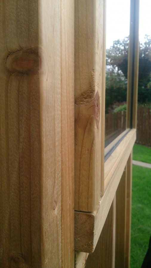

I suppose I thought the cladding would hold it together like in a normal shed. Do you not think this would stop it twisting? It is wobbly with just the frame up, felt sea sick after doing the roof.
I stood the window frames out 20mm so I could clad up to them so there was no cut ends of the cladding showing(See photo below). How would you suggest finishing round the frames if I batten and sheathing board it?
I am leaning towards doing it right what do most people use for sheathing? Ply or Osb? And what thickness could I get away with?

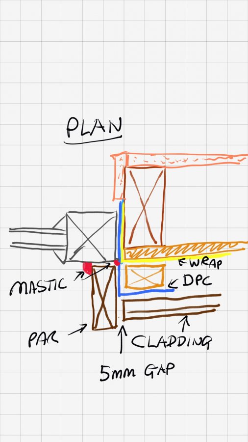

Here is s quick detail about how to finish cladding at the window sides. But you also need to know how to install the drips above the frame and below the cill.
You need 11mm OSB, ply or cement board to sheath the frame though. The cladding won't stop it moving or twisting.
Have a read up on timber frame panels and construction.
