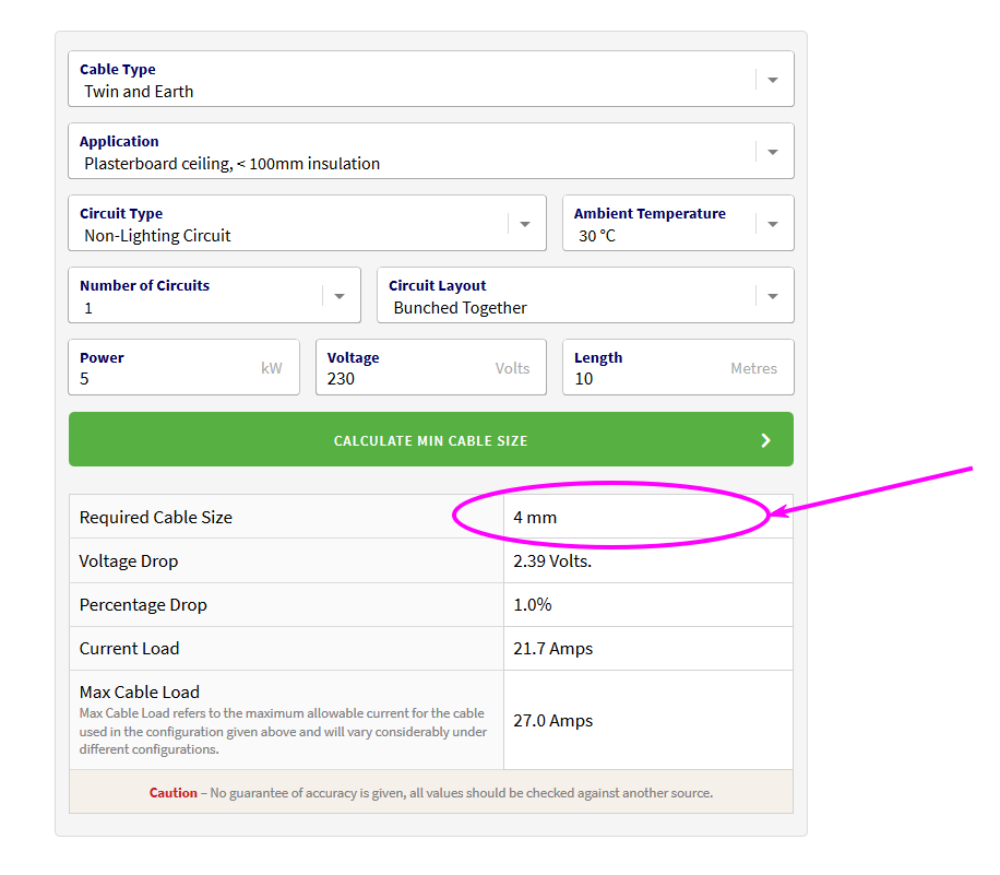

In what way is it hard to find the answer?
You tell it how long the run is, what the load is, what the relevant installation method/factors are, what the cable type is, and what the voltage drop limit is.
And it then tells you what cable size you need.
I'm absolutely not being deliberately obtuse - what problems were you having using it?
AFAIK the only gotcha it has is that if you specify 3-core cable it will assume 3-phase.
What problem(s) were you having?
It is hard to find the answer on the page, the formula would be as easy enough with a calculator. I guess it should be possible to view the page source and get their version of the maths from the HTML or Javascript..?

Perhaps the web page designers should check out browser foraging theory? Thanx for the photoshop pointer to the result, however, it is in a confusing format with all kinds of extraneous and potentially contrary information. I was just looking for the formula to work out the dimeter on an extension lead to run out to the pump in storms, not planning a bunched plasterboard lighting circuit operated at 30 degrees Centigrade.

It's not really a case of 'a formula', since the characteristics of cables cannot be readily mathematically modelled (at least, not without resulting in impractically complex formulae) - one has to ascertain the answer, directly or indirectly, by reference to Tables of current-carrying-capacity and resistance (hence voltage drop) of cables of the various available sizes under a range of installation conditions (which Tables have largely been derived empirically, because of the problem of mathematical modelling). That's what the on-line calculators do, and you'd have to do the same (refer to Tables) if you wanted to determine the answer 'manually'.

OP: You still seem to be assuming that it is the cable diameter (whatever that may be) which defines what you are after, whereas it is the cross-sectional area of each conductor in the cable which matters. This is measured in mm², often incorrectly written as mm. Just so there are no misunderstandings...

Perhaps people who want to do electrical design work (which is what working out the size of cable needed for a given application is) should check out what's involved rather than railing at websites and other people who do know what's involved when they give them the information they say they are looking for.
I cannot argue with your assertion that you are confused.
But I can assure you that you are completely wrong about "all kinds of extraneous and potentially contrary information" - there is not one bit of information which that tool asks you to provide which is not essential.
As John said, there isn't one, nor could there be.
And, BTW, you didn't ask for a "formula", you asked how to "work it out".

I'm looking to make an extension lead of over 60m to run a well pump of of the generator after storms or other power cuts. It needs to run the pump which is rated at 2400 Watts. What diameter cable is needed for this to allow for power loss over distance.

I've it sorted now anyways, DIY style, there was a load of advice on here (no money involved- but you still takes your choice) and the extension lead is made, tested and Brexit ready.
