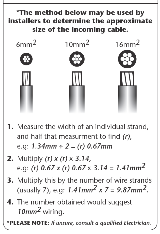

I want to upgrade a Triton electric shower from 8.5kW to 9.5kW but would need to swap the existing 32a CU fuse for a 40a fuse. Is there a way for an idiot to safely tell what size the wiring is on that circuit as I gather I need 8mm for the bigger fuse and have no idea what's installed?

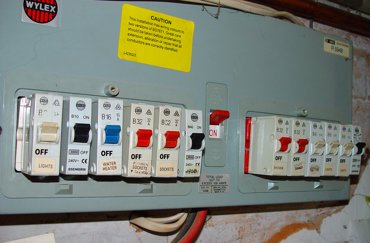

Also, I fear that my CU is at or near max capacity so need to check that the fuse upgrade won't exceed it. How do I find out? The board is a Wylex 1206 with a max capacity of 100amps but the aggregate rating of the fuses is over 200amps. Does that mean I'm chancing my arm if ovens, kettles, heaters, driers, laundry machines etc are all running at the same time?

I don't think 8mm cables exists.
It will be either 6mm (likely the same as your cooker circuit) or 10mm
Based on the Triton manual I have just read, you're right - but their cable sizing guide looks a bit clunky. Hopefully I'll find it embossed on the sheath.
No.
It's unlikely you could get anywhere near 100A even with everything on at once.
Even if you did, the supplier fuse for the property won't be more than 100A, so that will fail and disconnect everything.

Thanks - that's a relief …and so I won't fret about upgrading my shower fuse from 32 to 40a.
But I'm getting confused about the different types - and prices up to £30+ - of Wylex B40 40 amp fuses I can buy. I've found this one at £5.40 but it sounds like it won't work in my old-school CU:
https://amzn.to/3jZU5cs
…and then some are C40 which means nothing to me except that I should presumably avoid.
I do have one (old) Wylex B40 40amp fuse installed which has "3000" stamped on it and not much else. So any advice will be much appreciated.

40A MCBs for that fusebox are obsolete. 6/10/16/20/32 are the only values available now, other than dubious used efforts from ebay and other vendors of tat.
It might be possible to use the 40A 'hob' one for the shower and the 32A for the hob, however that also depends on whether that particular fusebox can support 40A devices at all - many were limited to 30A maximum.
Those that can do 40A devices typically only allowed them to be installed in one specific location.
If the shower cable is 6mm² is may be possible to use that with a 40A device, although how and where the cable it's installed will need to be established, as will the total length and various other factors.
Although one has been mentioned, there is no RCD in that picture.
Ultimately that fusebox is several decades past it's replacement date, your existing 8.5kW shower is already overloading that 32A device, and the noticeable difference between an 8.5kW shower and a 9.5kW shower is somewhere between insignificant and none at all.
