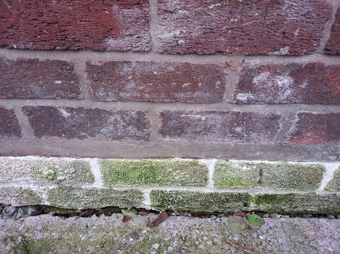

it's been repointed over. The moss and stains show there is a great deal of water there. Please stand back and take a wider pic. You need to find the source. It may well be a broken drain or pipe leak. Show all pipes, manholecovers, drains, and also the gutter and downpipes.
the white marks are often found near a washing machine, from the soapy water.
