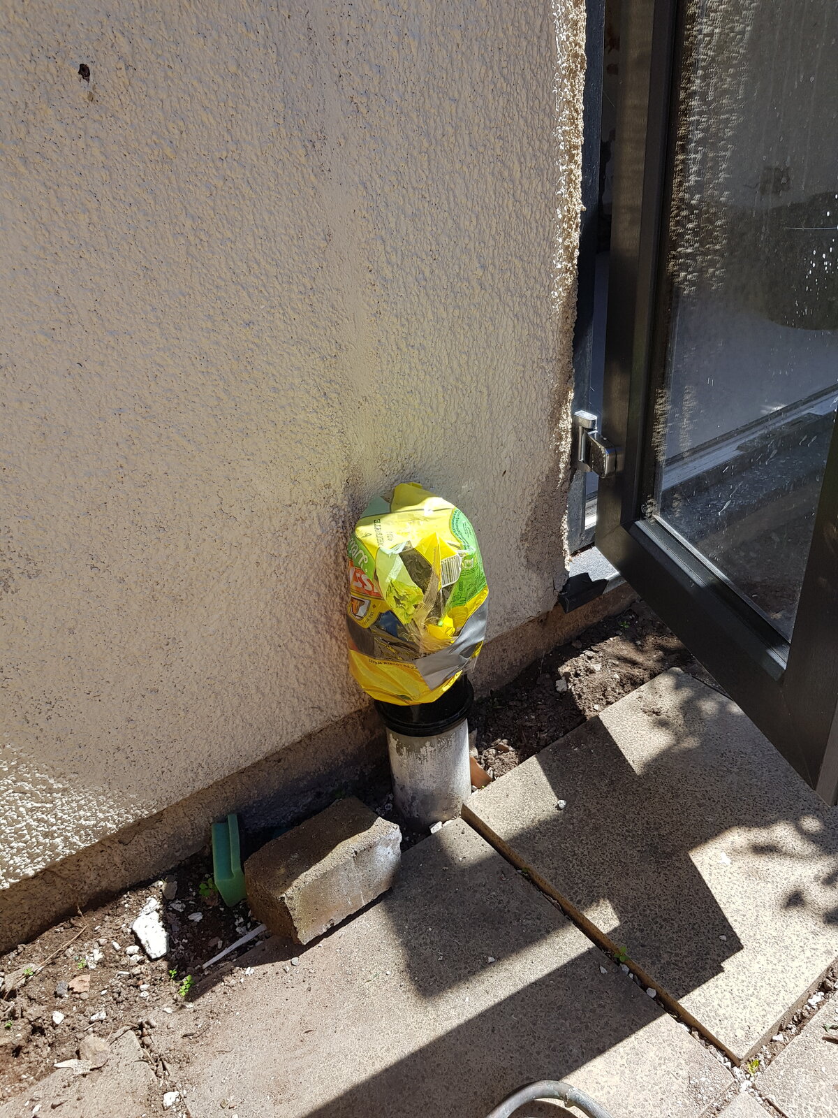

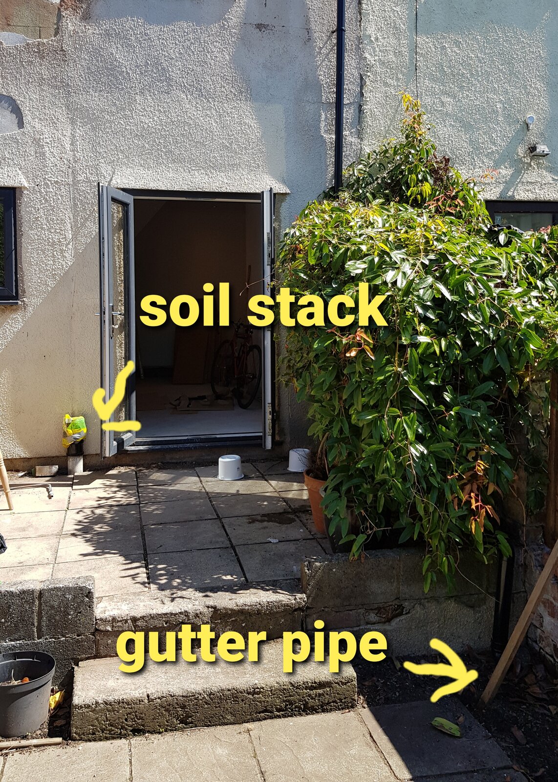

Hi, I'm trying to sort out the back of my terracedhterraced Victorian houseahouse garden.
As you can see in the photos, the soil stack ends up just going directly into the ground, where I imagine it bends away from the house and meets the sewage pipe that the neighbours say run horizontally across all our gardens.

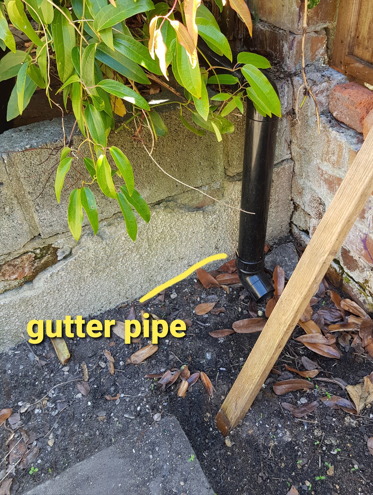

Then the gutter down pipe travels a few metres from the house and then just empties on the soil in my garden.
Is this normal? My neighbour says hers goes into a drain
Should I be doing something different with the rain water/gutter pipe? Also is it normal the soil stack just goes into the ground like that?
Should I have a drain somewhere. Sorry I'm new to all this!
Ideally rainwater discharge should go to a soak away 5 metres from the house and not too close to your boundary.
It seems to be discharging a few metres from the house so is probably fine.
If you want to deal with it properly, dig a soak away and put in a soil pipe leading to it. The best soakaways these days are aquacell type crates as they have virtually 100% capacity.
Bear in mind soakaways only work in porous soil, so you might want to do a percolation test first.
Yes, that's normal.
The soil stack should extend up the wall and terminate above 2nd floor height with a vent cap grille. Has yours been removed while you were hacking render off. Or was it left at ground level like that by previous owners?
I took off the soil stack to replace it, and then found the wall was a mess. Now I'm planning to get external wall insulation. The previous soil stack was a mess, but was set up basically correctly as you say.

Well I agree with what @Notch7 wrote in that reply. It is not ideal. Best solution is dig a 1m3 soakaway cube. But, it has been that way probably a long time, the ground slopes away from the house so the water table will too. You don't have damp wall problems anywhere near discharge?
The other option is to configure some drainage gulley into the main drains if the house and adjacent houses are on a shared foul and rainwater system. i.e. rainwater goes into the main drain and mixes with foul waste. However, it is generally frowned upon to go back to mixed system if the water was dealt with separately by discharging in the garden.

Thanks, this is all new to me. I only just learnt about the soaraway box from you! I could dig a soakaway box in if it would be helpful. Do you think it needs to be that size minimum?

Properties of that era rarely had separate systems of drainage, rainwater from the rear either went in with the foul, or onto the ground. (The front roofs were often drained straight onto the road, where the water found its way into the road gullies, which were piped separately to a suitable discharge point.) I'd hazard a guess it used to go to a gulley, and as Ian has said, that gulley has become blocked, so the pipe was diverted away rather than the gulley be unblocked.
Some further investigation perhaps required.
Ok thanks thats interesting. It must have been like that forever. Its a good few metres from the house, and down a couple of steps so Im guessing this is safe enough to not affect the house? I had subsidence issues a while ago from a leaking drain so I'm paranoid!
