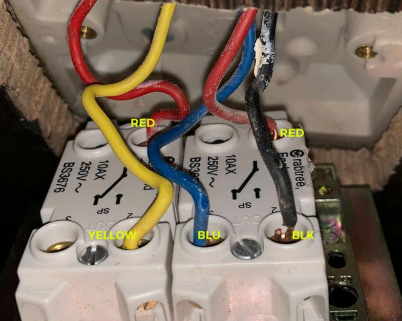

Guys, I have just noticed that right inside the sheath for the red,blue,yellow cable is a copper cable, assuming this is the earth?. On both the Landing Switch and the Downstairs Switch it is barely visible, certainly not connected?
Technically it's called a CPC - Circuit Protective Conductor. At the moment it isn't an earth because it's not connected to anything.
In theory, if you went round all the points the cables go to (including the fuse board), stripped back the sheath and reterminated, then you'd have earths. In practice you'd be one exceedingly lucky person if any one of them, let alone all of them, have enough slack to do that. If you can get enough length to get at the CPC, then they could be extended - but you do need to do that on every cable between the switch and the earth in the fusebox, just connecting them together doesn't create an earth.
As I said, the mind boggles at the mindset of someone that takes the effort to chop them off rather than "park" them in the back of the box. Even if they CBA to terminate them (as if that's hard :whistle:), just slipping them in a bit of sleeving would have meant that they were there for you to simply connect now.

I opened the switch on the room adjoining the Landing and the earth is actually there and attached to the earth connector, so it seems some of the other lights have been butchered by others. When we first bought the house we had work done, it is Grade II listed, but we had someone in to do roof tiles, take out flooring and put new boiler in. They did a lot of Gas work, with boiler and fireplace and after the work I wanted a certificate. After months after the work was done it was still not forthcoming, so I got in touch with CORGI. Despite assurances these guys were registered they were not. I made an official complaint to CORGI and all they did was ask them to get registered. They did not and probably went on to do more work. I have to say I was very unhappy with CORGI. But I don't know if these builders fiddled with these connections?
It's unlikely that they did anything with your lights.
