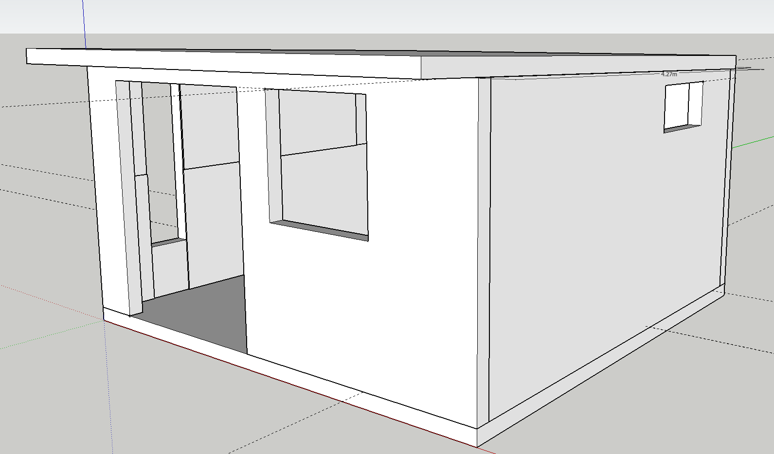

So the time has come to finally start my Garden Office build project.
I've posted some info here - https://www.diynot.com/diy/threads/garden-office-project.523670/, but the TL;DR is that I'm building a 4.27m x 4.27m garden office using SIPS panels at the bottom of my garden.
As this is intended to be primarily used as a home office, I'm adding a small kitchenette with fridge, sink and microwave, and a cloakroom with toilet and hand basin so that I can work down there all day without having to venture back to the house.
The current design looks like this:
There's a small overhang at the front to allow for some downlights etc.
The rough interior layout currently looks like this:
The corner sofa is likely to change, and is just there for a sense of scale currently :)
Kitchen wise, I'm thinking either Ikea or DIY-Kitchens. Both price out about the same for a similar high gloss grey/blue kitchen.
Cloakroom will be either a wall hung or back to wall toilet, with a counter-top sink situated on-top of the toilet cistern, similar to:
So yeh, that's the plan soo far...
