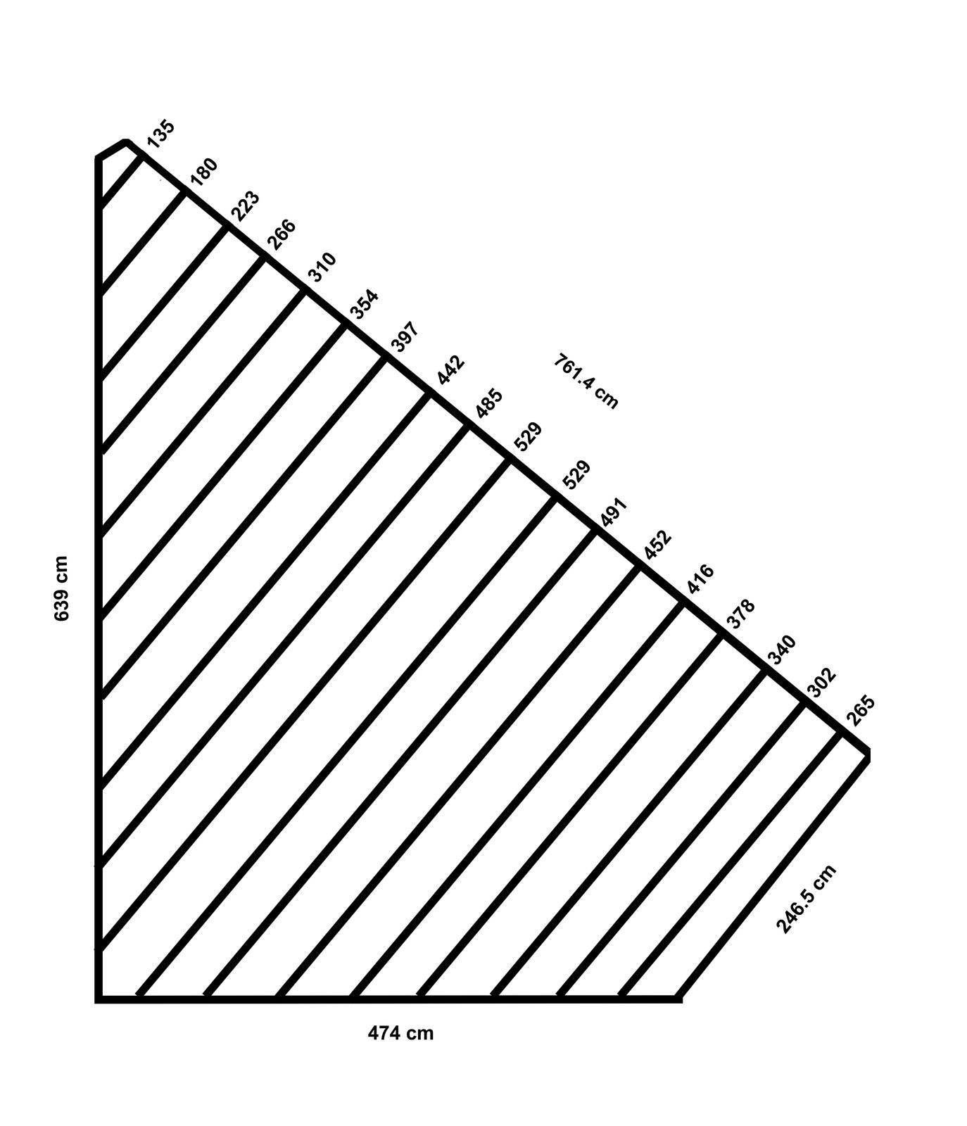

Hi, I am building a garden room which is not your 'standard' shape, using the space I have available. I have almost completed the foundations and basic floor base (see pics).
I am trying to keep within permitted development, under 30m2 and within 2.5m maximum height. The issue I'm having is in the roof design. I was planning on a flat ,cold roof, using rubber EPDM, but having trouble visualising the layout of the joists and fall. Thought I would post here to see if anyone has come up against this 'challenge' before?

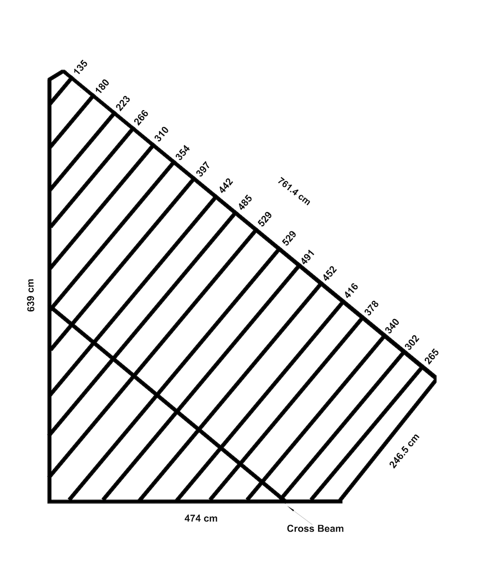

I am looking at the Spanning Tables for the roof joists (https://www.timberbeamcalculator.co.uk/span-table/flat-roof-joists?load=0.75&class=C24). Roof joists will run from left to right, same direction as floor joists, fall to the right, hedge side. There are 18 joists, 16" centres, all of varying lengths, so trying to work out what I can 'get away with' in terms of joist height, as I am using permitted development, overall roof height can't be anymore than 2.5m, so roof joist height is important, every mm counts. Could I get away with C24 47x170?
Here are the clear spans for my roof joists.
they should be at 16" centres not 16" apart so iff its say 48mm its 14and 1/8th" apart
if its 51/2" its 14" apart
Yes, sorry, 16" centres, I corrected it above.
not being picky just making sure we all are singing from the same hymn sheet :D
i should have said do you mean appart or centres
havent done the calculations but iff they are very very near you may get away with tight noggins right at the end from 485-491
or even doubling up on longest 4 timbers
also iff the point is the high side then perhaps a 4x2 flat side on from perhaps 442 to 452mm may help
just ideas as its a challenge
also worth noting in a structure its often easier to have a transition or short flat section so you can put change off angle on horizontal timber connecting to verticals rather than having to angle full length often on more than one face off a single timber making it impossible often overly weak
now in your drawing it seems to be allowed for but worth a mention
Thanks big-all, although I'm not sure I understand some of your suggestions:
"also iff the point is the high side then perhaps a 4x2 flat side on from perhaps 442 to 452mm may help" - Could you explain what you mean by this please?
"also worth noting in a structure its often easier to have a transition or short flat section so you can put change off angle on horizontal timber connecting to verticals rather than having to angle full length often on more than one face off a single timber making it impossible often overly weak
now in your drawing it seems to be allowed for but worth a mention" - I don't understand, could you please explain?
Kind regards.
instead off the firings at that point you have a cross beam helping to support the joists to the wall sideways now it wont do a lot but iff your over span by say 10% it may bring it nearer to zero
Apologies, I'm not sure I still understand you. You mean like this (the fall is from left to right in direction of joists)?
