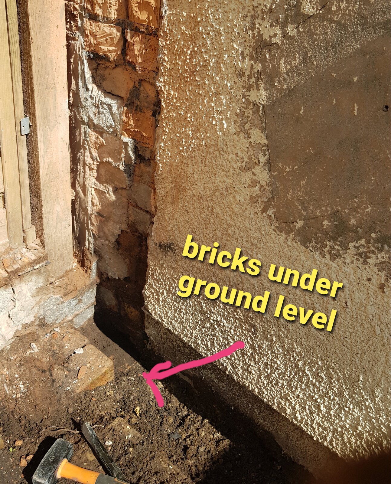

One other question, I grinded the garden wall and chipped it back flush. But there are bricks below ground level still tied into the wall of the house. Should I keep digging down and try and grind these off and get rid of them too? (See photo) I was worried about these bricks moving damp into the house wall, but also don't want to mess with the foundations! :)
Probably being paranoid
In my opinion no. Below DPC level doesn't matter, if you remove the bricks then any infill/soil will be touching the wall, same difference.
Ok thanks. How do I know where the dpc is if I cant see it?

Chip out a little mortar from each bed and you will find any DPC if one exists in the wall.
Work from low to high - how low i dont know because i cant see where the render stops.
