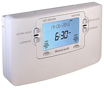

Honeywell ST9400C programmer
https://www.screwfix.com/p/honeywell-st9400c-programmer/88608
User guide
www.honeywelluk.com/documents/User-Guide/pdf/871.pdf
