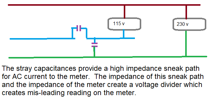

Low voltage on 30 amp Cooker circuit
Years ago it was easy, measure on 250 volt range and 500 volt range and see if reading changed, but the days of the analogue meter are gone, the new digital meter is more like the valve volt meter, it hardly draws any power.
10MOhm I think and supposing the break in the cable (assuming) is around 10MOhm then the measured volts will be around the 130v the OP claims to have measured.
The point, or rather load you are missing - is the load of the meter itself. It might be a tiny load, but none the less it does form a load and the voltage it will see, depends very much upon the value of resistance at this poor connection we are assuming. ... John - you must have come across situations where the testing process affects the measurement itself?

Even analogue meters were generally no worse than about 10kΩ/v - hence about 5MΩ on a 500V range, and the digital meters of today are at least that high - so the high resistance you are postulating would have to be 'megohms' to result in a 115 V drop - pretty unlikely in a circuit which 'sometimes works'.
I suppose it could be an intermittent 'complete disconnection', such that the meter was measuring between L and a 'floating' N.
However, even if that conceptual explanation were correct, your suggestion of measuring L-E voltage would not be 'foolproof'. The same mechanism would presumably apply if the 'megohms resistance' were in the L, rather than the N - and in that case the measured L-E pd as well as the L-N pd, would be 115 V (or whatever).
Kind Regards, John
True, but we're back to Mr Kirchoff again. If (per your diagram) the measured L-N voltage were 115 V because of a broken N conductor, resulting in a capacitive divider between N and E, then the N-E voltage would also be 115 V (co-incidental, since 230 = 115 x 2), not (the reported) 'zero volts', wouldn't it?

It wasn't - apologies for my imperfect memory. However, you did respond to my comments about sparkwright's suggestion with your suggestion as to how L-E could be measured as 230V, even though we had been told that L-N measured at 115V and N-E as 0 V - and all the subsequent discussion has related to that.

You're right. I suppose that our minds were focussed on the fact that 115 is half of 230, and therefore (particularly me, but also even bernard's diagram) have been typing 115 V throughout this thread!
However, that oversight does not alter anything else which I (or anyone else) has written.
