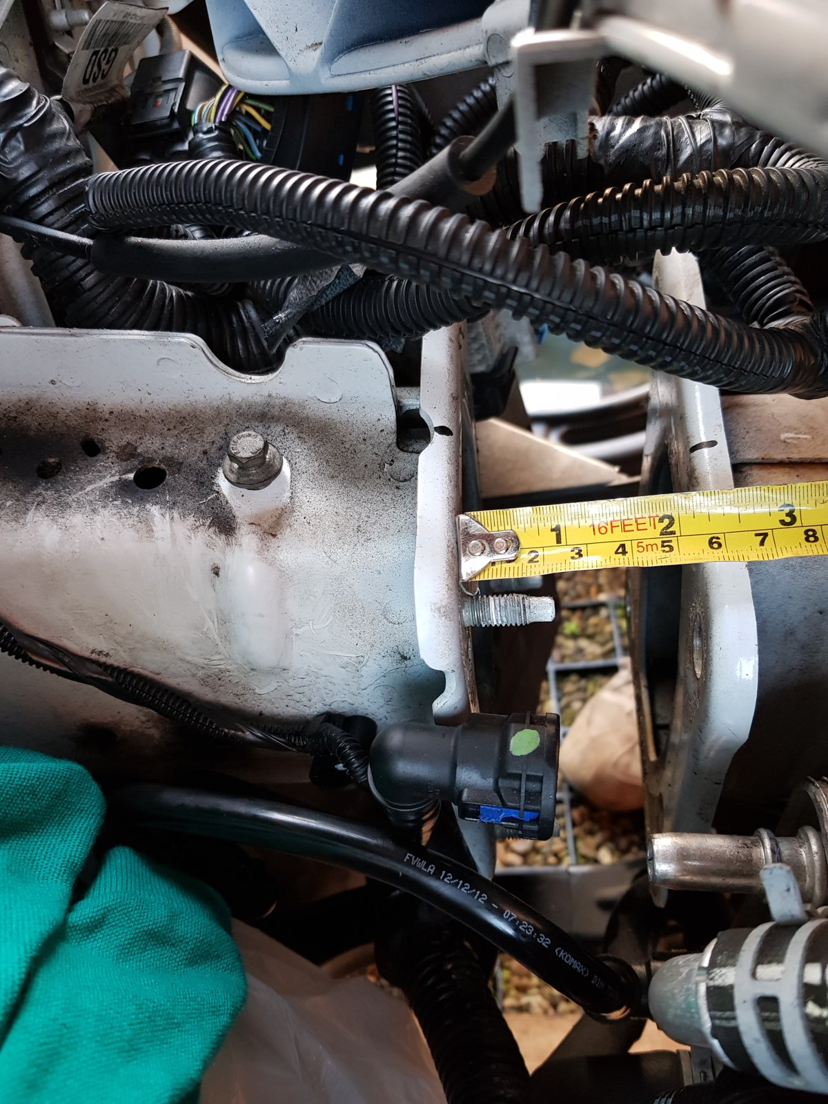

Managed to get all jobs done at work this morning so took pm as a holiday.

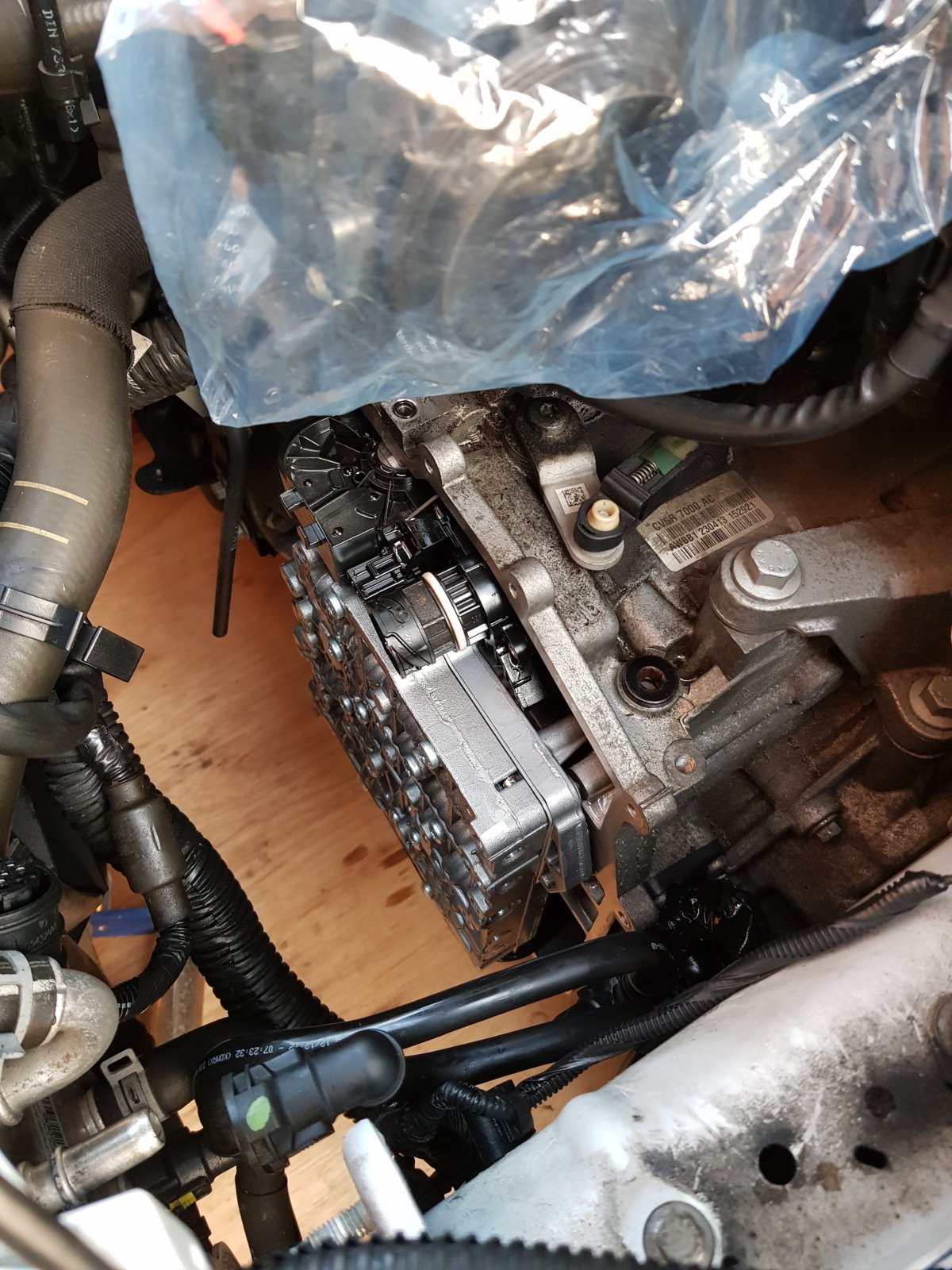

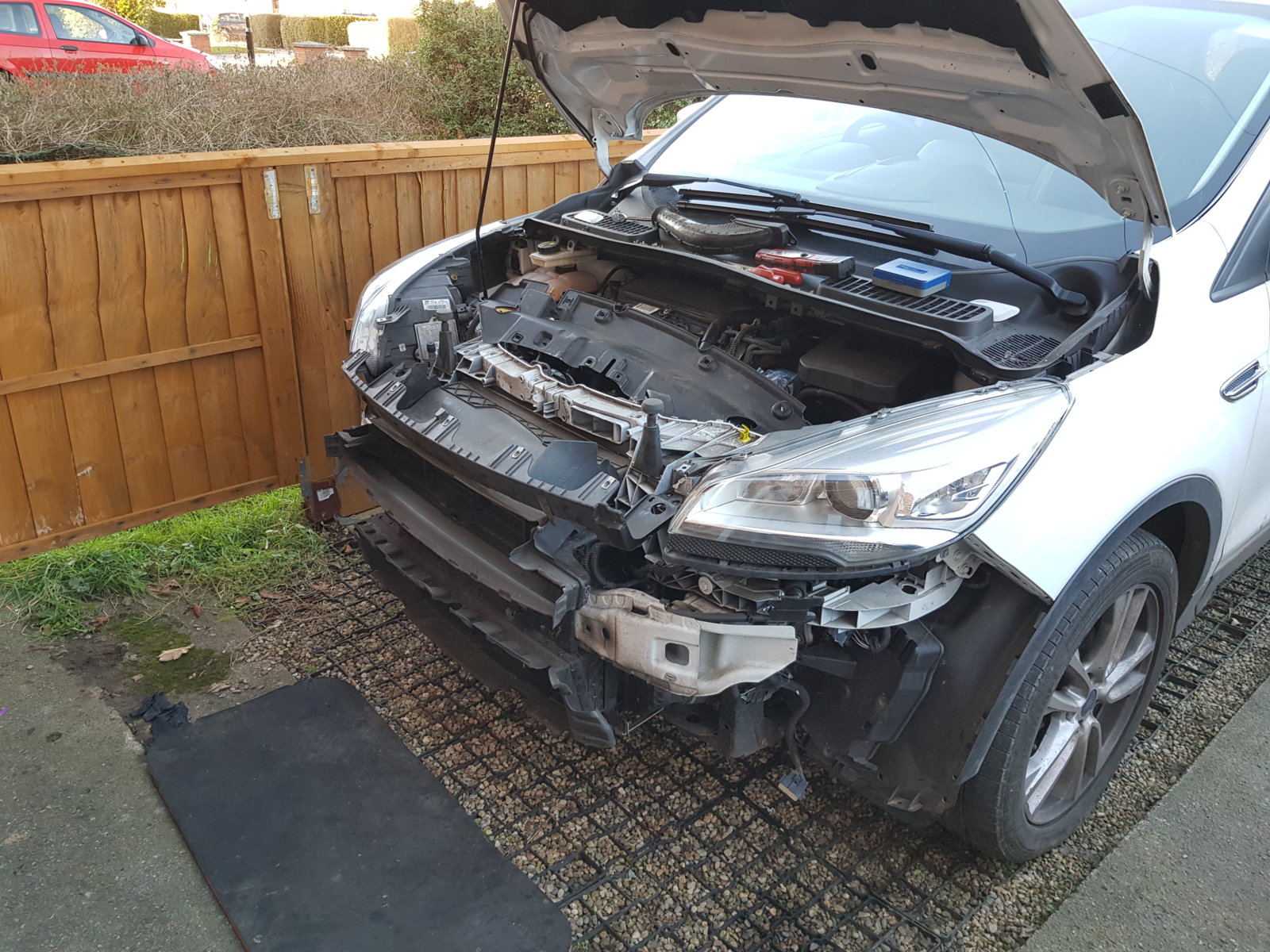

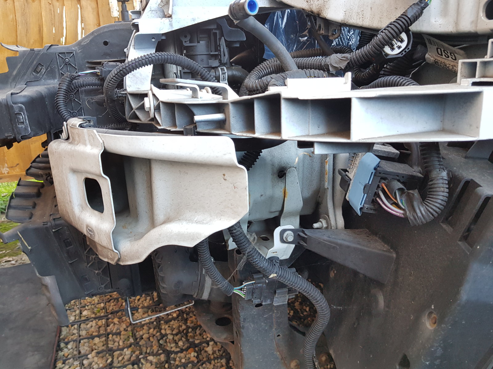

Dug into the car, I needed approx 10 inches of extra clearance to get the Mecatronic unit out (easy peasy..).
Be all and end all due to how they've designed the MK2 Kuga I've had to remove the entire front of the car!.
A couple of in progress pics but I was racing against the light at the end.
Will be stripping the valve body down tomorrow.
It's cost me 5 hours, on the Mk1 you can remove the fan assy for clearance.
On the MK2 the slam panel is in the way so it's all off, bumper/ lights/ wiring/ crashbar and part of the subframe..
Will take some pictures tomorrow.
Must admit the wiring loom is very well secured and built, see quite a few loom faults at work due to vibration and chafing but Ford have done a good job there.

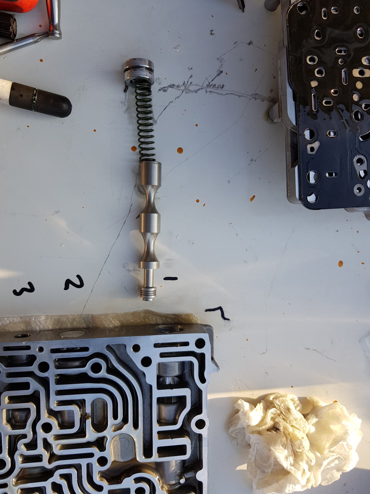

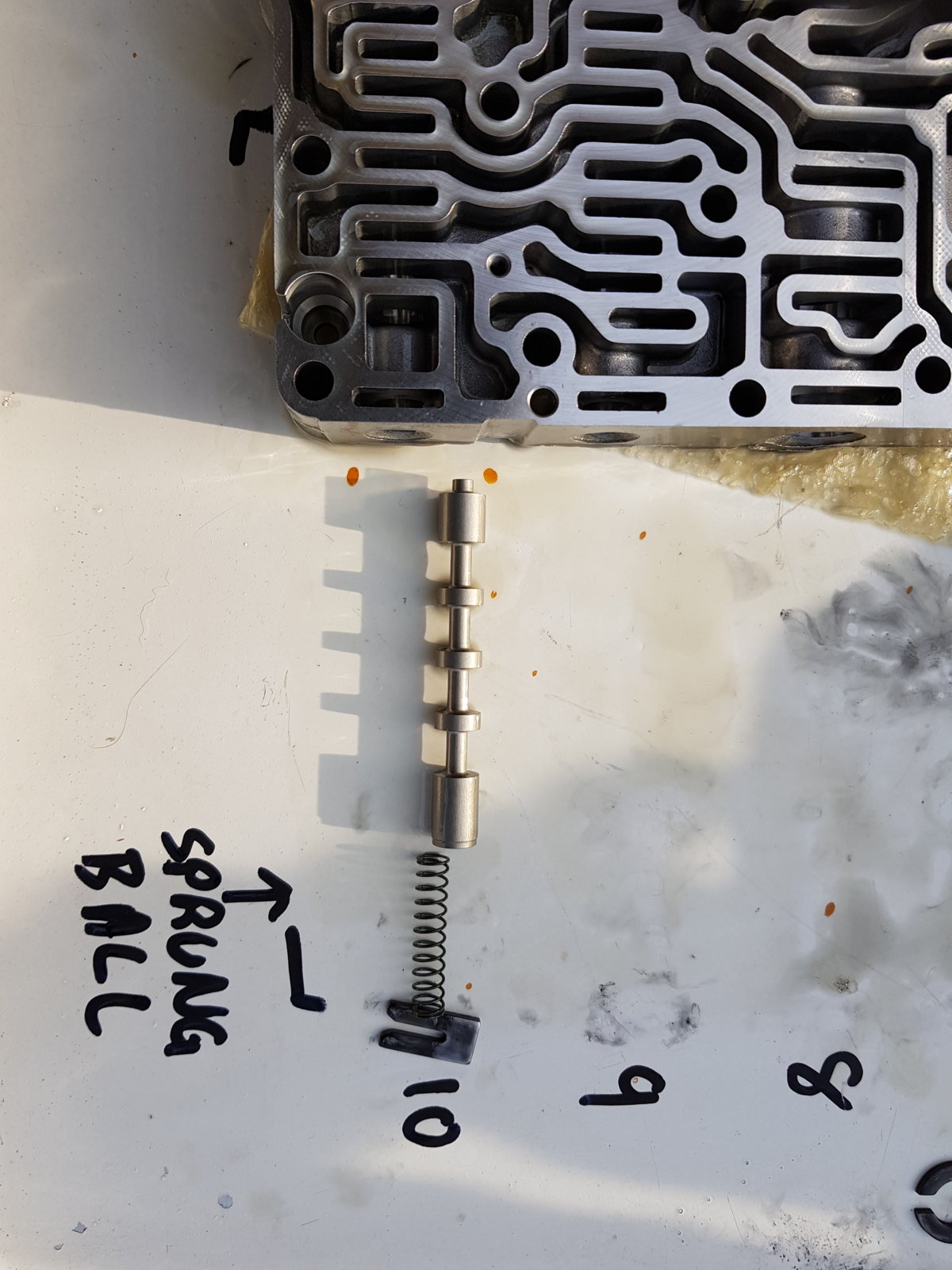

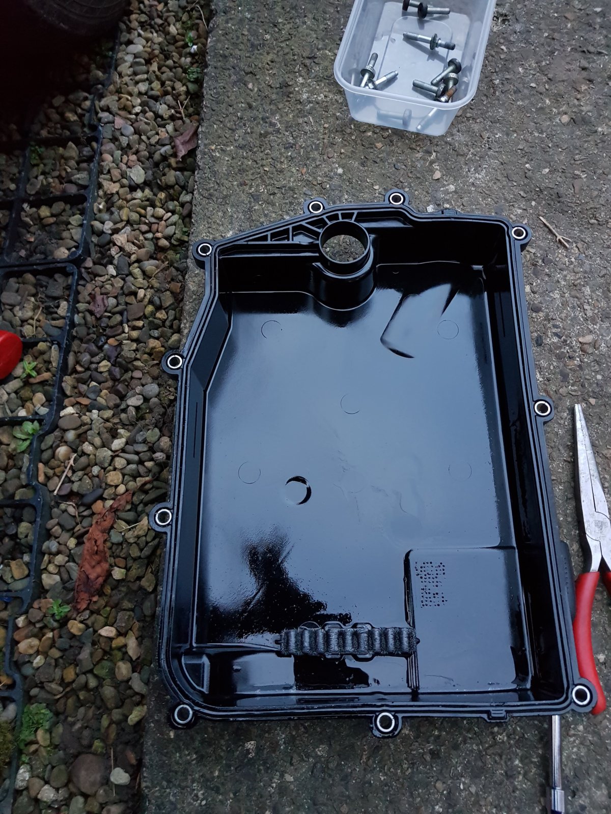

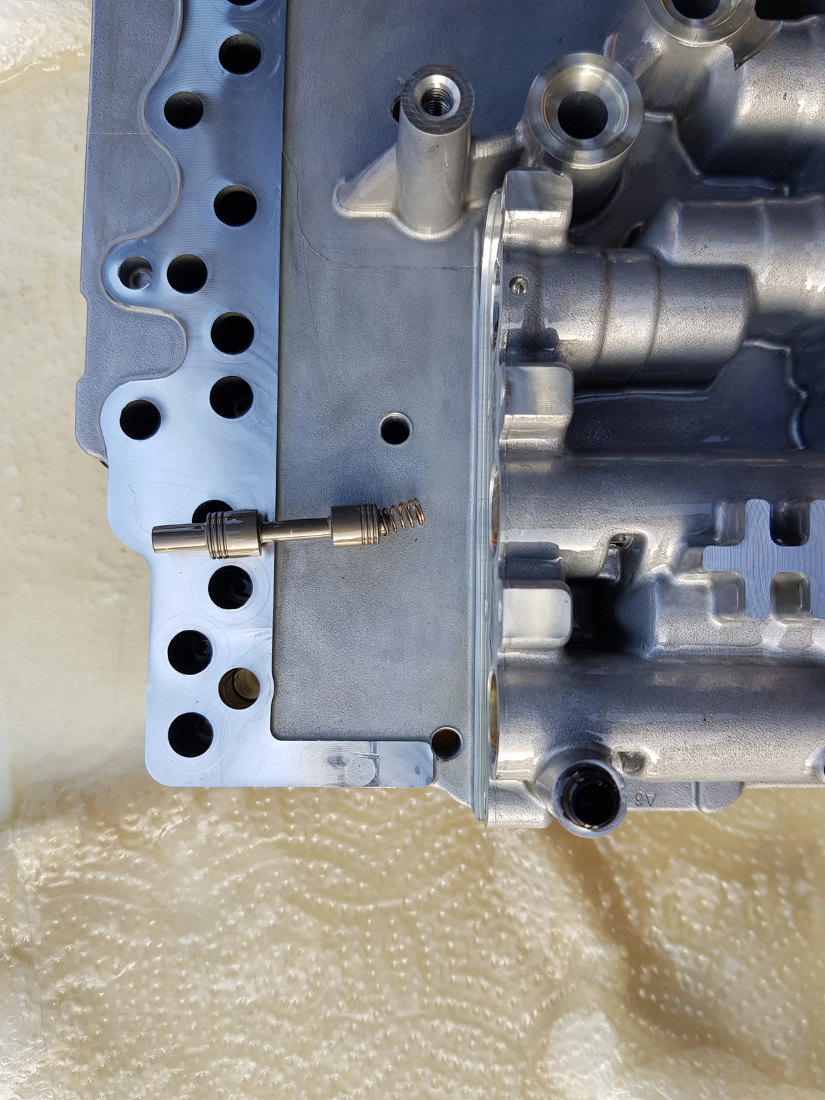

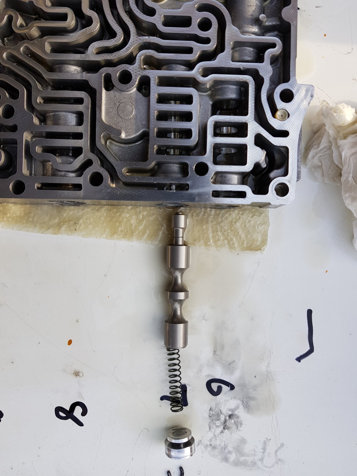

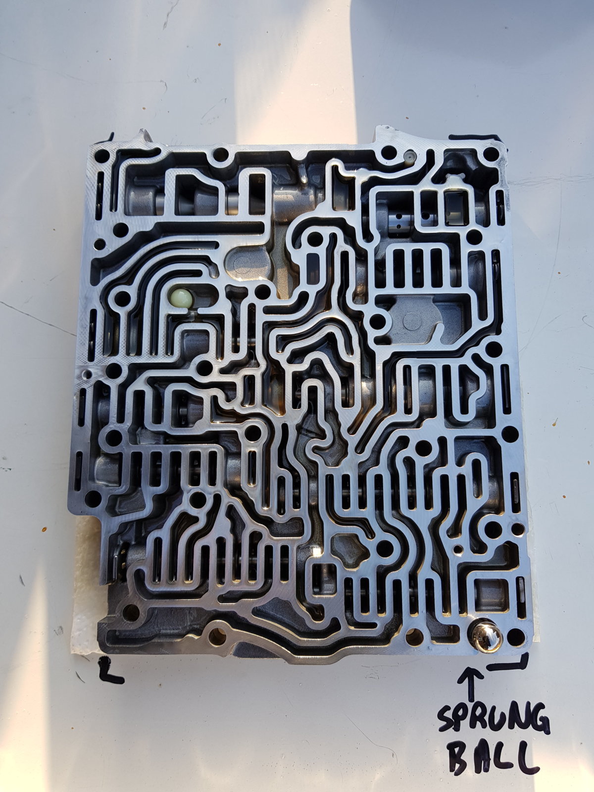

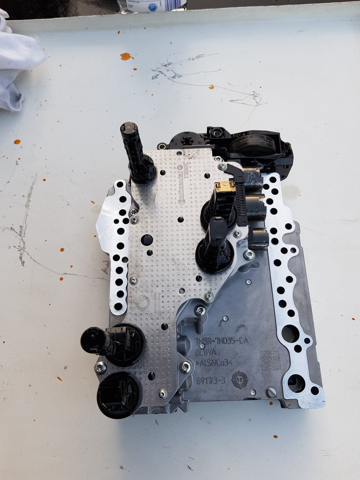

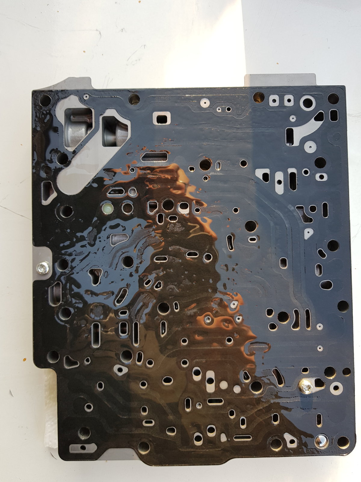

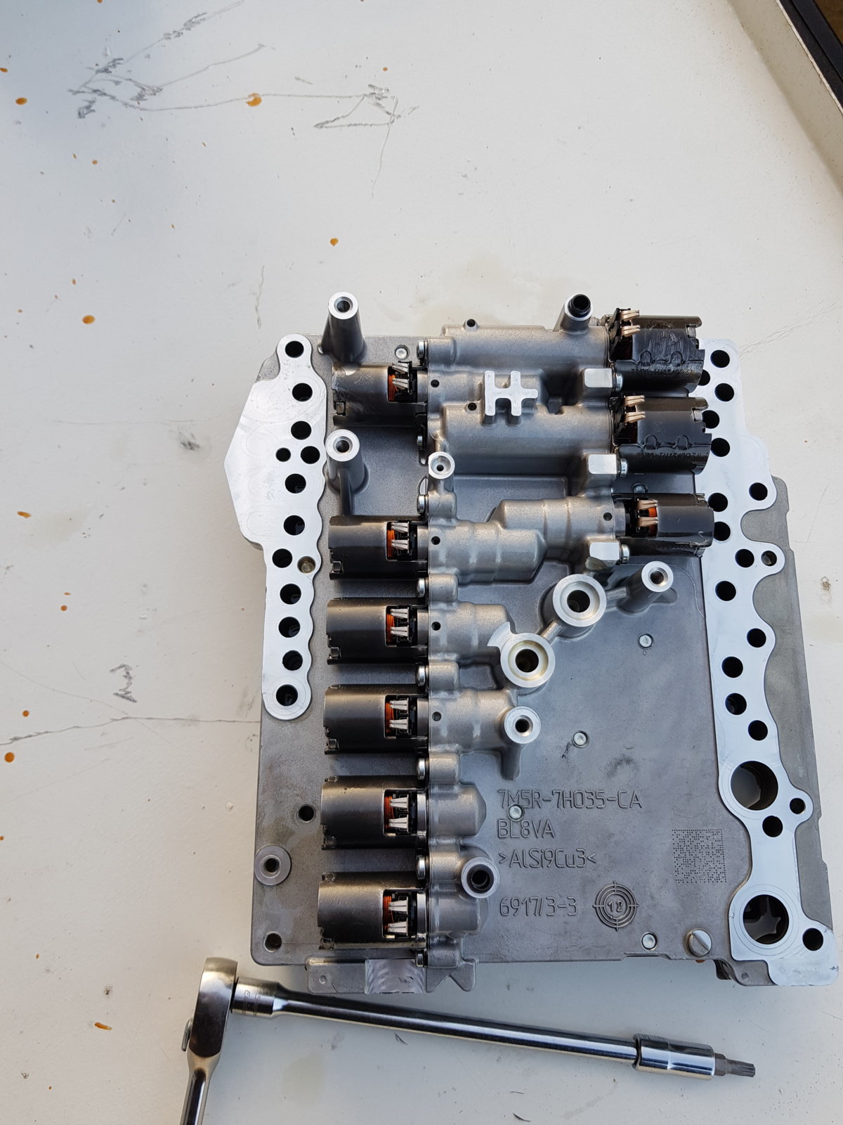

Here you go John, I decided the wet clutches couldn't possibly be worn out at 67k so decided to try a Mecatronic rebuild first.
Two full days of graft to get unit out (basically front of the car had to come off first), stripped / cleaned / inspect and test all solenoids (9) and actuating pistons etc.
Took my time stripping it and photographing everything as it's extremely complex.
I soaked the solenoids in Seafoam while I serviced the valve body.
I was a bit annoyed not to find anything obvious, all the internals look like new still.
Was a bit weary before test drive but she's smooth as silk!, best it's ever driven.
Done 10 miles tonight and need to put some more on tomorrow but very hopefully indeed!.
Ye gods :eek:
Thanks ever so for the update, makes for incredible, if not terrifying, viewing!
Everything looks absolutely perfect, no wear or debris visible......on occasions when I've been into things as deep as this (but never so complex) and not found anything I tend to find the original fault is somewhere else after all :eek: - if indeed I can find it!
Fingers tightly crossed for the outcome, but if the fault returns, where do you go from here?
