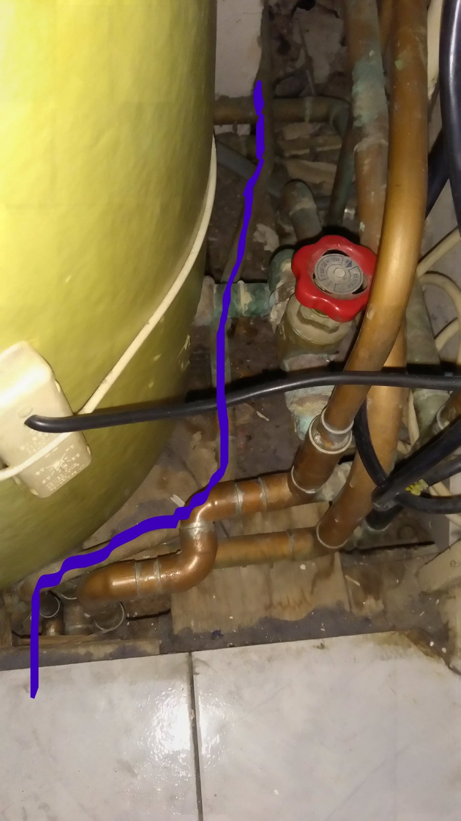

I have a hot water cylinder with a boiler. I recently drained the system and washed out the radiators.
I have no hot water and no heating. The boiler fires up, the 2x two port valves turn the valve to their open position. The water in the pipes surrounding the cylinder is getting hot but not the radiators or taps.
The pipes around the water cylinder get hot except for the bottom one and the top one. I've posted a picture with the water flow / temp if each pipe.

Terry, yes, the hot water cylinder is hot and there is hot water coming out from top pipe and the two side pipes.
This 15mm pipe (blue line in pic) is cold so I'm guessing this is the rads pipe? all other pipes from boiler to cylinder are hot.
