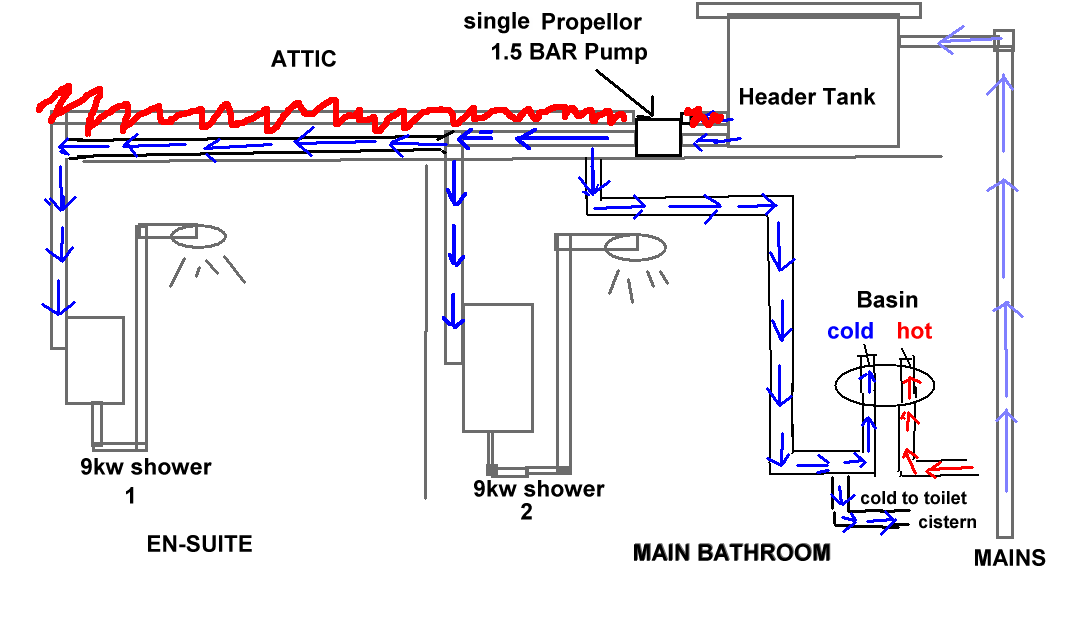

Pump at bottom of header tank in attic

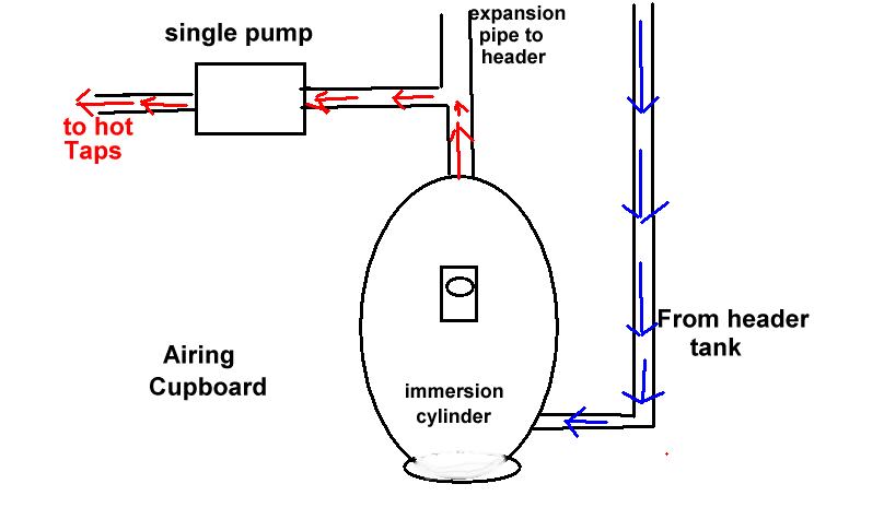

how about this idea, and I know it is not the ideal way it should be and that the shower units should have their dedicated pipes coming from the bottom of the header tank (is this so someone in the shower wont get scalded if someone turns on the cold tap on the basin or flush the toilet?) but how about I take the cold pipe exiting from the bottom of the tank and just put a single pump on it then link up all the pipes (cold pipes to the showers, basin/sinks, toilet cisterns) to the outlet of the pump and then put another pump for the Hot pipe coming out of the immersion heater cylinder for the hot water circuit of the house ... would that be doable?

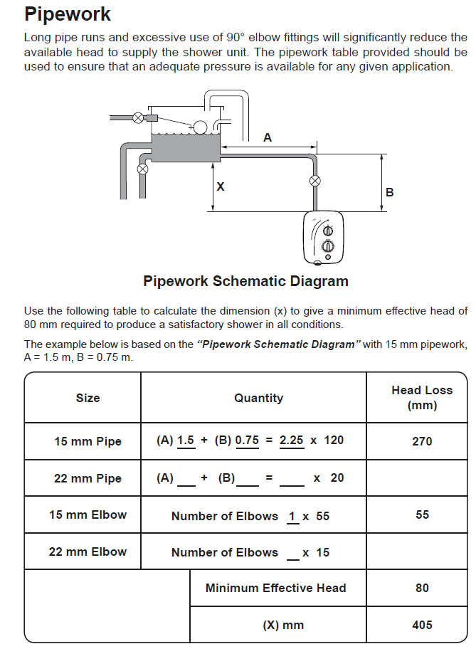

What size pipe feeds the showers? Pressure and flow rate are two different things.
If you don't have much head pressure (ie not much fall between the tank and the outlet) you can compensate by having a larger bore pipe so that you have better flow for the same head pressure.
I think from memory when I had the covers off the shower they are 15mm - was thinking larger bore pipes but again a load of work needed taking out all the 15mm and putting in 22mm - there might not even be the space to , and in any case it will still have to be reduced down to 15mm at the shower connection

You shouldn't need another pump under any circumstances as long as the shower is 0.5M or so below the bottom of the CWST even if using 15mm piping.

aside from the showers, the cold tap on the bathroom basins, the bath tap , the slow filling toilet cisterns then wouldnt it help anyway putting in a pump where I was thinking of putting it?
Basically, yes, but I wouldn't have it pumping into the shower inlet even with a pressure reducing valve, you will then have to consider pumping the hot as well?, you are then looking at a twin impeller pump which don't come cheap, if the shower's flow problem isn't its own pump then it points to a restriction/blockage from the CWST which is the first thing to address as the proposed pump will not perform either, sort that out first and then make your decision.

A pump is one option.
Another option is to investigate the pipework.
For instance, is every cold appliance in each bathroom fed from that one 15mm feed? Do that headloss calculation - a well designed run (with swept or formed bends rather than elbows) will give better performance without the noise and expense of a pump.
With the cold there are benefits (especially with a low head) to going larger on the tube size (hot is different, you can end up wasting a lot of water with oversize hot feed).

i am going to try the suggestions first - but if I went down the road of deciding to fit a pump to improve the pressure on the cold from the storage tank I am presuming if I put the pump up in the attic for them and place it at the bottom of the header tank that I would have to go for a Negative Head pump?? - a Positive one will only work if I placed the pump in the airing cupboard instead where it has some gravity coming from the header tank yes? -
putting it at the bottom of the cold water storage tank means no gravity and so a negative head shower pump needed yes?
