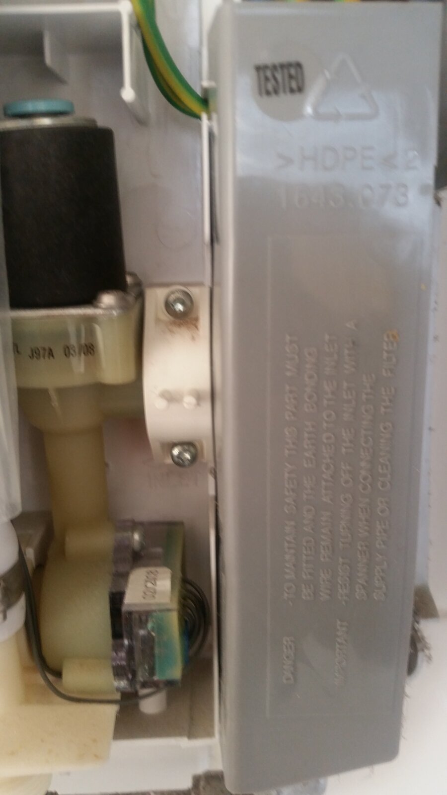

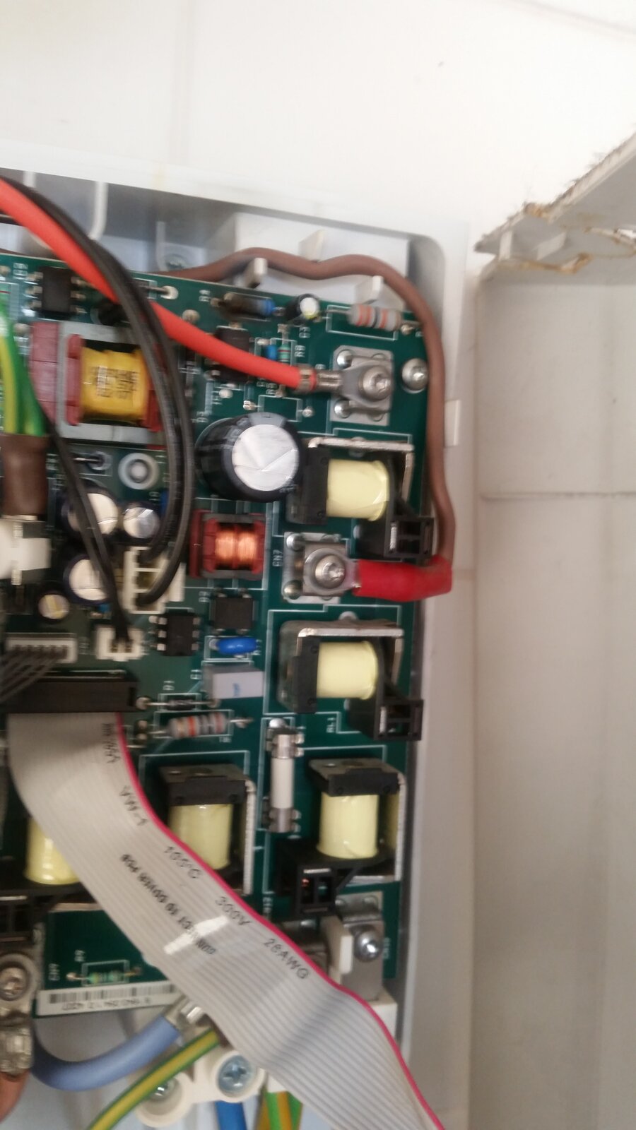

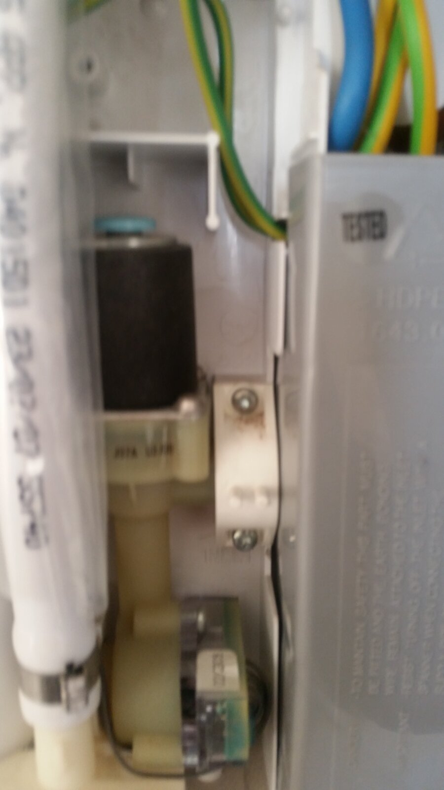

I have a mira advance atl thermostatic shower which won't turn on, no lights at all and no water supply.
I've read some forums about replacing the solenoid coil, I can't seem to identify if this shower has one?
Is any one is able to help how I can restore my shower much help appreciated it.
Have a good day all.

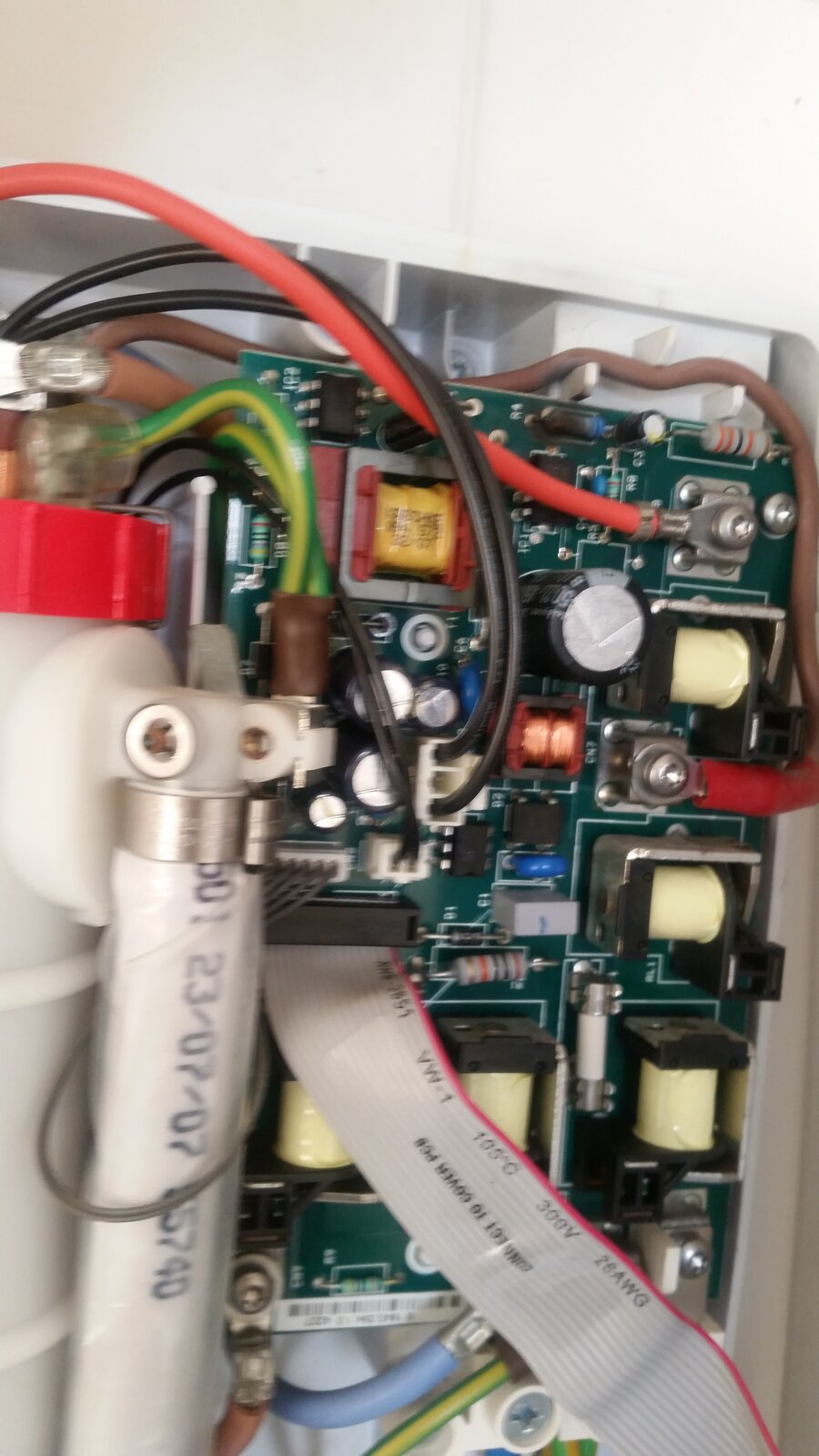

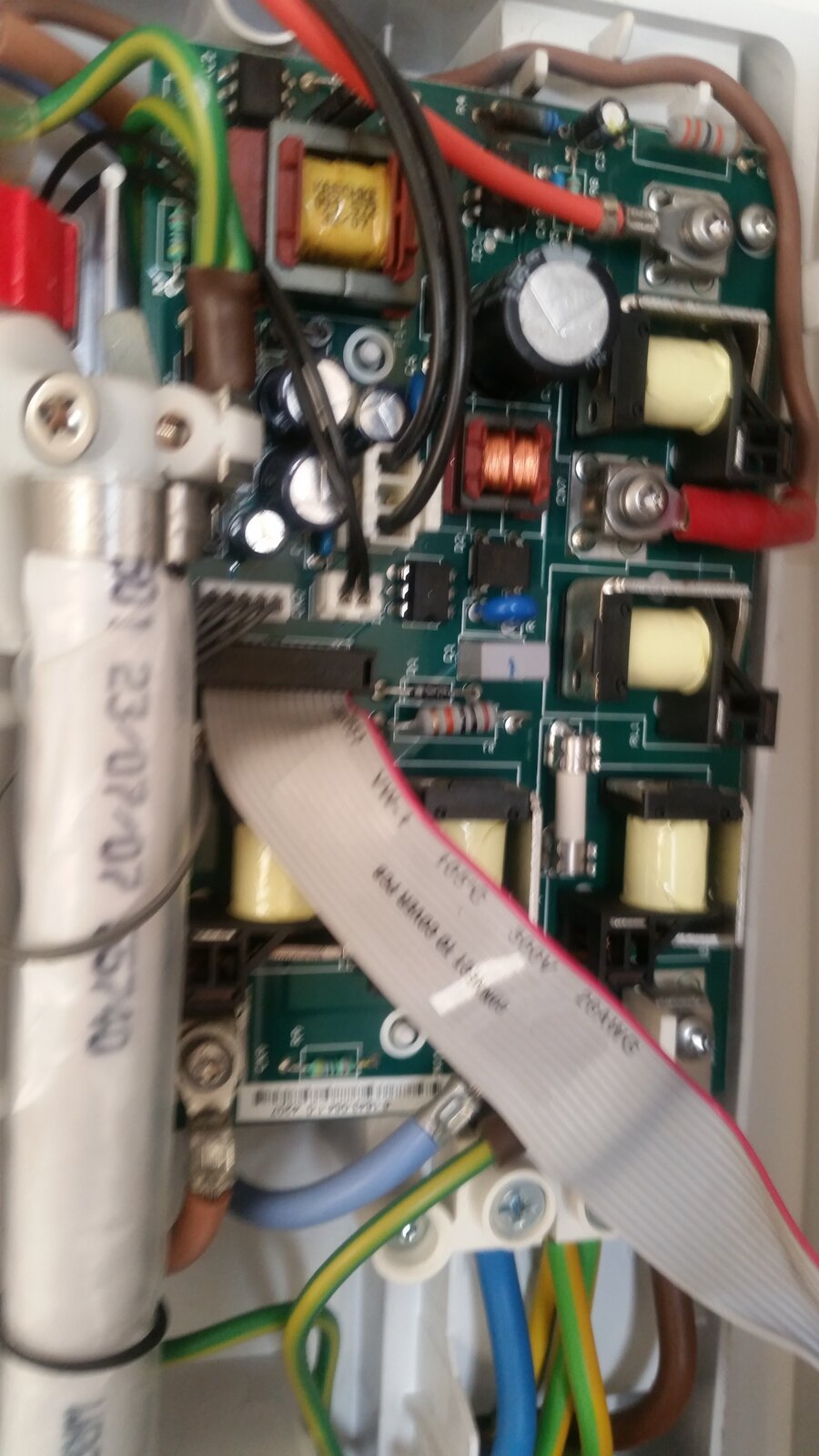

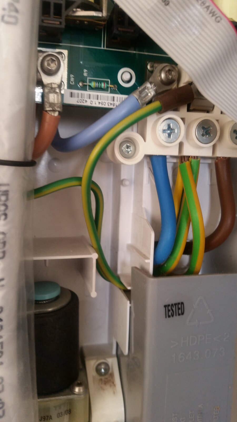

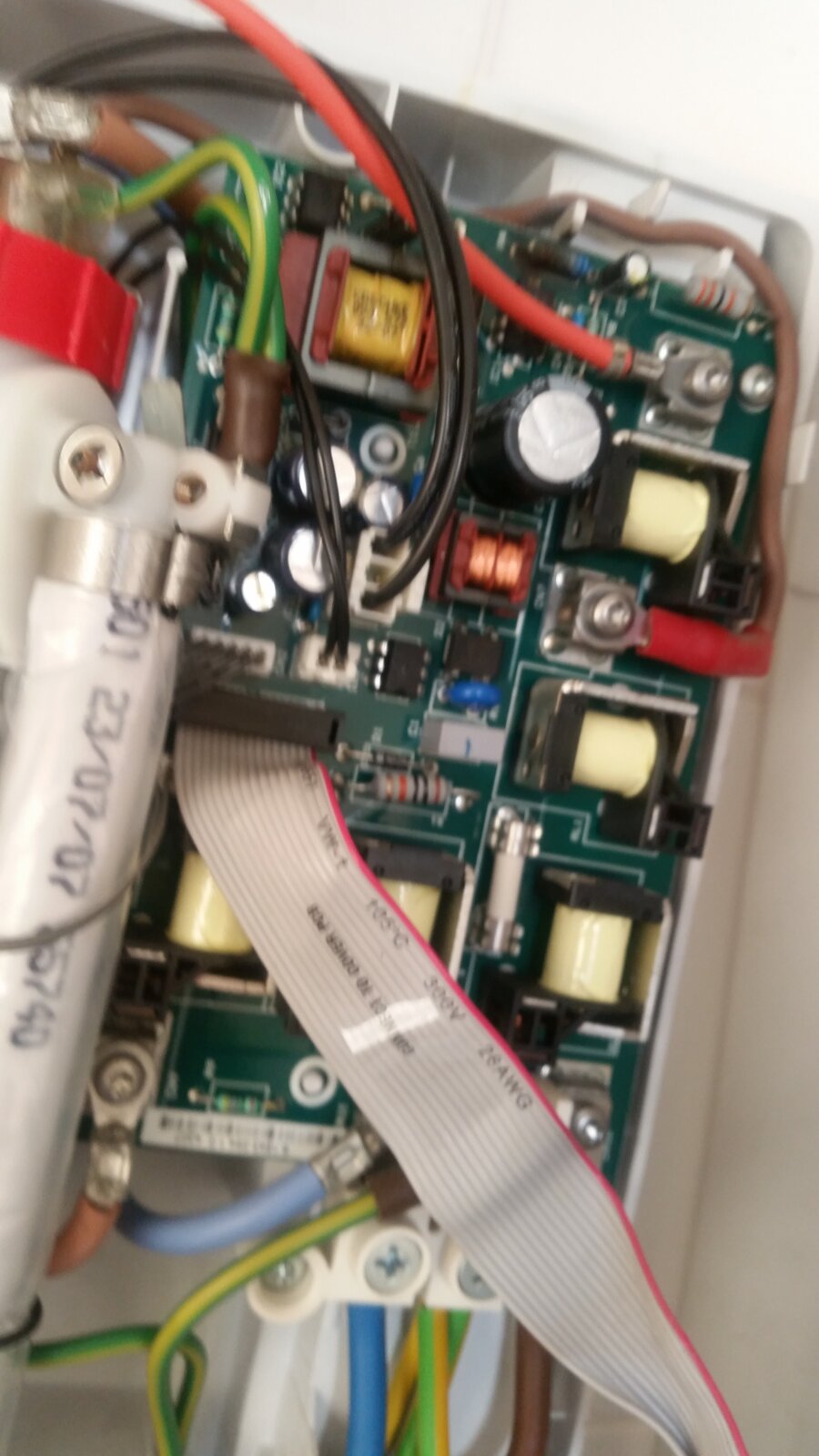

Would you know the point to check on the images uploaded ?
If you meant to test for voltage then yes I do.
Test between L (Brown) and N (Blue) and you should have at least 220vac
Test between L and E (green/yellow) and you should have similar to above
Test between N and E allowed up to 15vac

Thanks for the input and sorry for late reply, I finally got a hold of a multimeter.
If i've done this correctly all power to shower was switched off mcb and pullcord. Water turned off aswell.
Held 2 poles as mentioned by Chris, touching over the two screws.
RESULTS
0 on all three reading
Humm thanks for identifying that. I guess that means a complete board replacement.
That resistor should be replaceable if your handy with a soldering iron.
And for the tests with the multimeter you need the power to the shower on, if not your not measuring anything
