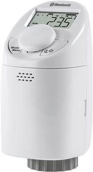

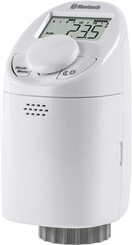

The Wiser instructions are hardly going to tell one you can get these EQ-3 Bluetooth Smart Radiator Thermostat.jpgcheap heads for other rooms, I paid £15 each in 2019. So if my family all go to bed at 10:30 pm if we have a wiser head in the slowest bedroom to heat, we can have cheap ones in rest of bedrooms.

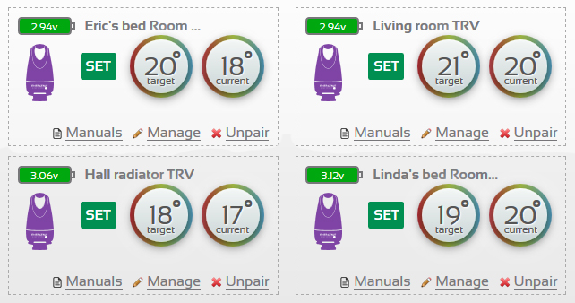

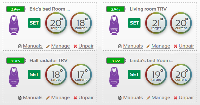

I tried to set up late mothers house, TRV-report3.jpg it had target and current, so if current exceeds target then close the lock shield a tad, and soon I got rooms spot on. These did not link.

The Wiser instructions are hardly going to tell one you can get these View attachment 294749cheap heads for other rooms, I paid £15 each in 2019. So if my family all go to bed at 10:30 pm if we have a wiser head in the slowest bedroom to heat, we can have cheap ones in rest of bedrooms.
I tried to set up late mothers house, View attachment 294752 it had target and current, so if current exceeds target then close the lock shield a tad, and soon I got rooms spot on. These did not link.
