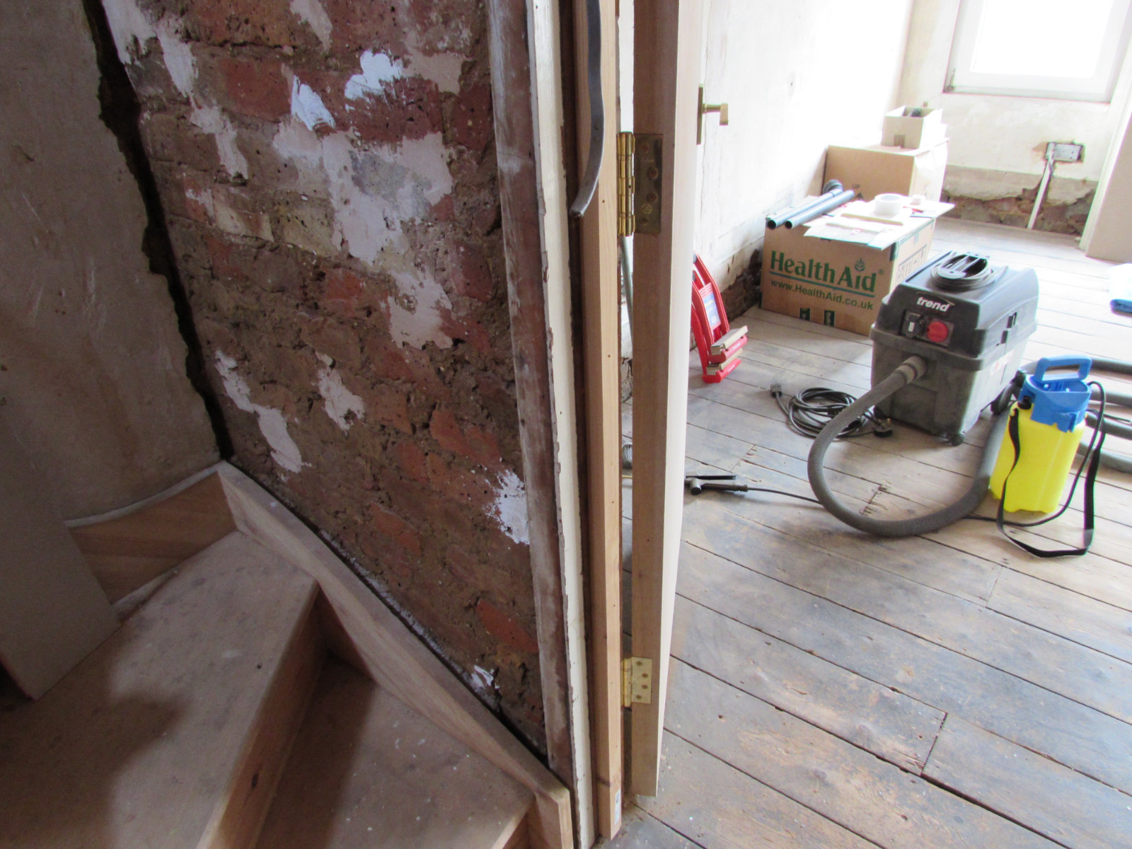

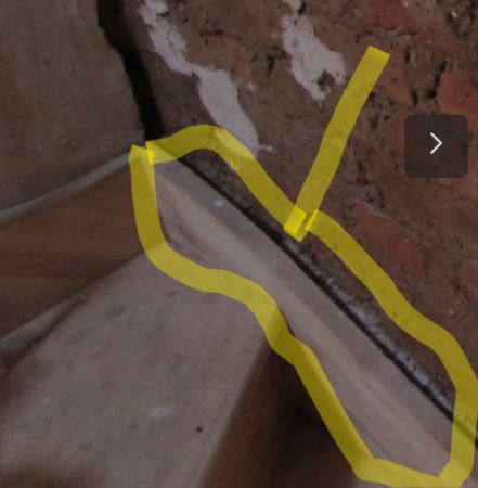

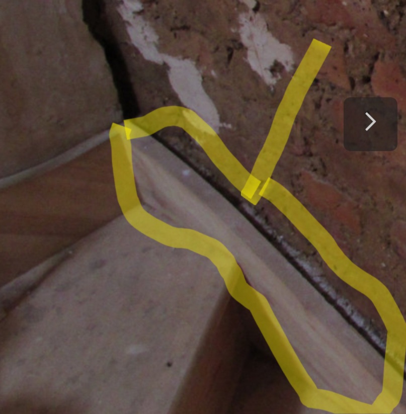

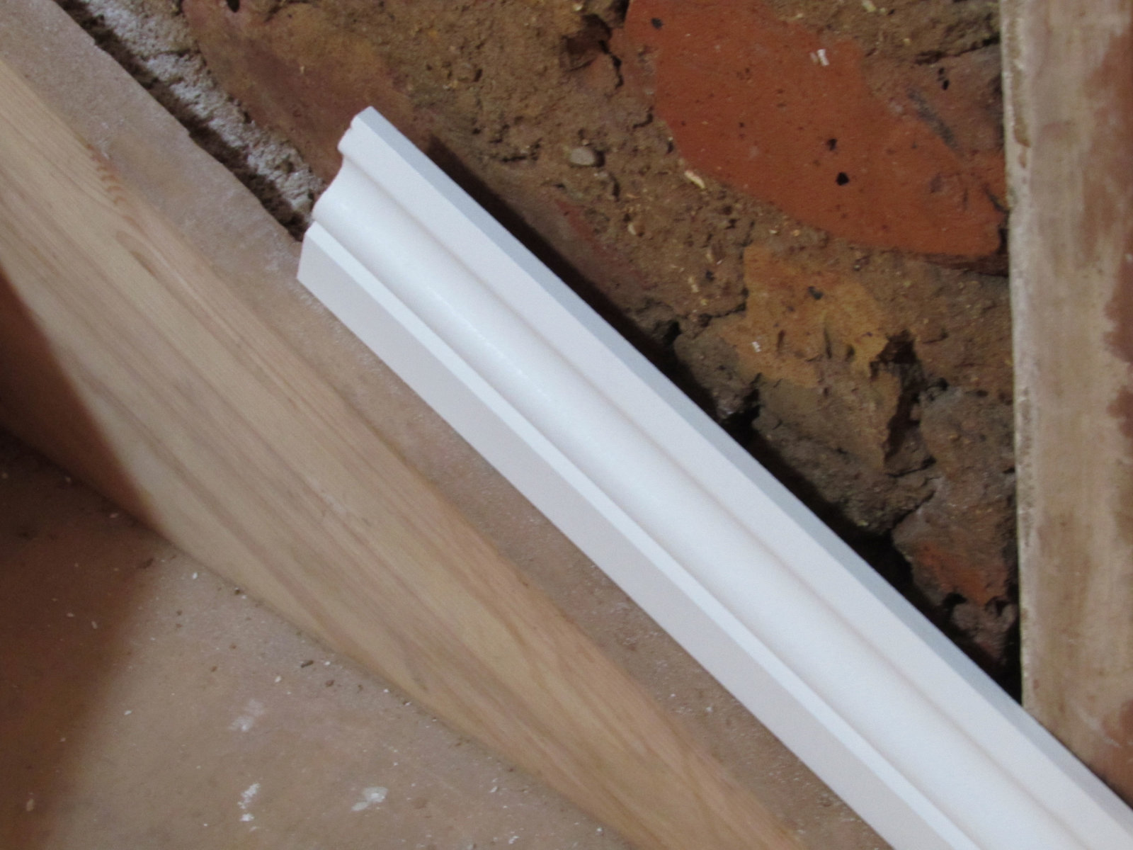

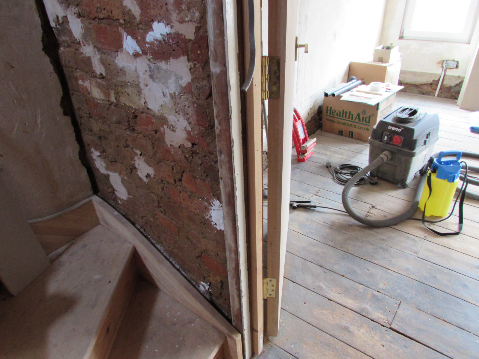

I have a renovation project on the go but have an issue with the stairs skirting board on the first two steps.
I will be putting some decorative rail on all my skirting boards, and it will be stepped back a few millimetres.

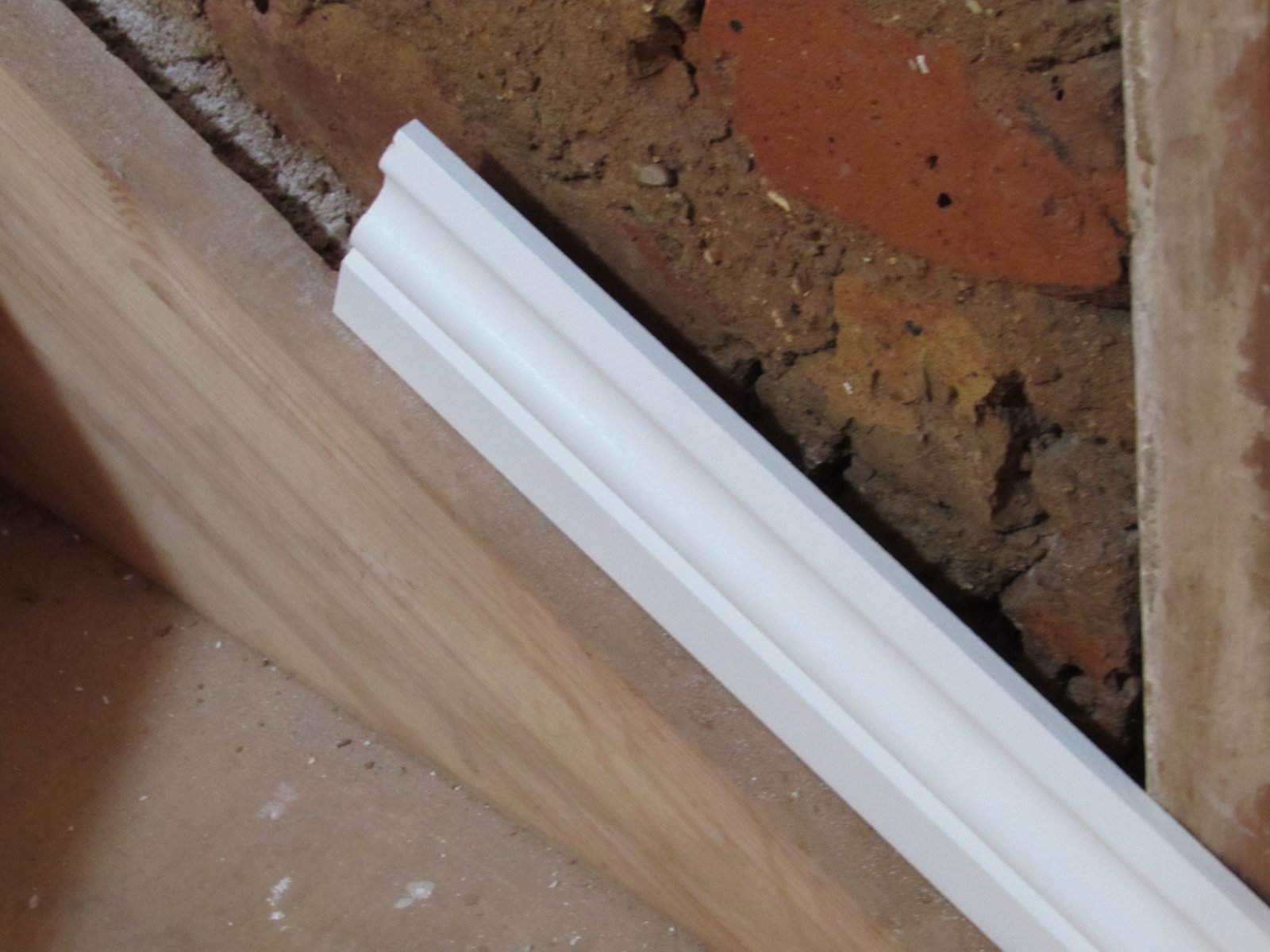

After plasterboarding and skimming the wall to be flush with the door frame, there will be a 10mm gap between the wall and the staircase. This will position the rail too far back as shown in the pic.
The easy fix would be to clad the door frame with 10mm timber and bring the plasterboard out a bit further. However, the door frame is already pretty substantial, and I have another door almost next to it on another wall that is half the depth. I really don't want to increase the difference between them any further.

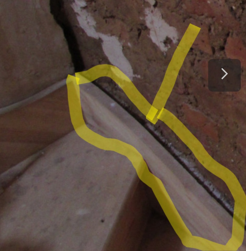

Plan B is to remove the staircase skirting on the two steps at the bottom, probably with a multiTool, make a new bit of skirting and reposition it flush against the wall.
I'm just wondering if I'm missing any other solution, and would a MultiTool be the way to go? I probably wouldn't be able to reuse the bit I cut out as it will get butchered when cutting around the front curves of stairs. But it should be intact enough to use as a template.
Any thoughts?
