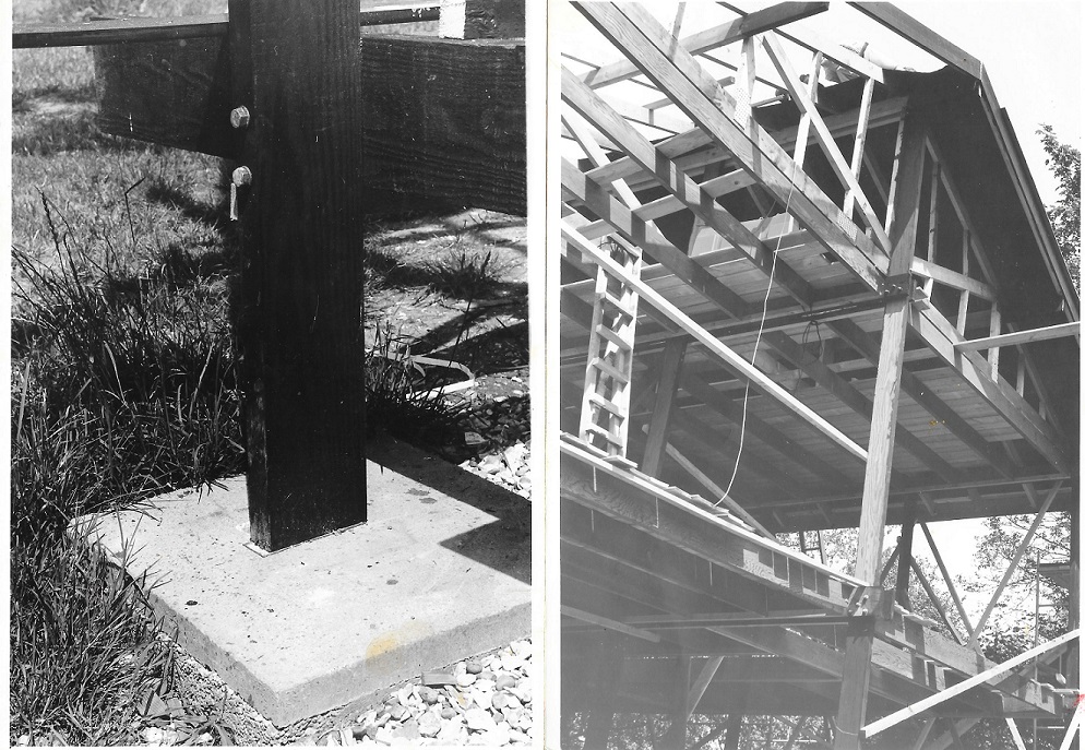

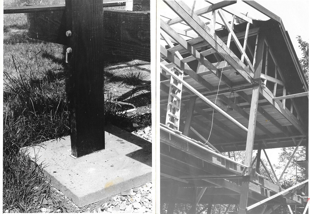

An alternative is to create pad foundations and stand the posts on a piece of 4 mm thick sheet lead. The post is not fixed to the pad in any way other than by the weight of the summer house.
I did this with a log store I built. I had felled an ash tree and used the branches to build the frame for it. Rather than stick the upright branches into the ground and concrete, I rested them on pads with a circular disk of stainless steel below, which were then put onto 2" thick slabs. Might not last decades but I expect it to be up for the duration of my time at our house.
I'm still thinking about the concrete posts into the ground idea, but should it prove costly to do this I'll consider the posts 'resting' on concrete pads. Creating a frame from this and then fixing the summer house to it would work and there would be more than enough weight to keep the thing rooted down.
