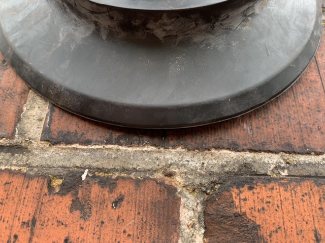

Pungent fumes in bedroom.
there's a smell and excess humidity.
Could a condensate leak be the cause?
3.23 says care needs to be taken to locate flue outlets away from parts of the building that may be damaged by frequent wetting.

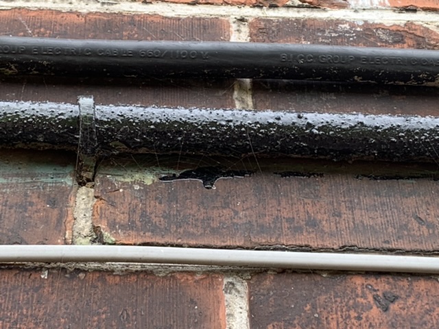

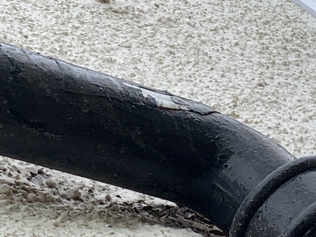

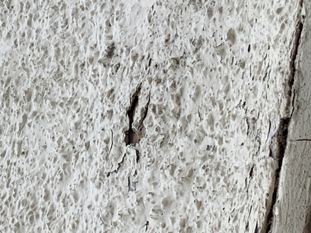

The render which was fine now has a hole in it directly above the outlet. To the right the paint is coming off the waste pipe. The paint on the gas pipe above the outlet is bubbling off only in the area directly above the outlet.
So it’s not ok.
Only until I had the boiler installed did I have these issues. For 20 years before no issues.
With respect the flue is not even close to any of the things above. You seem to be fixated on the boiler which you say has been checked over by the manufacturer.
The render will get "wetter" by normal rain much more than a boiler flue.
He also said that he sees many flue holes not sealed.
Whilst some manufacturers say it’s ok to use a 3mm thick rubber he said that it isn’t.

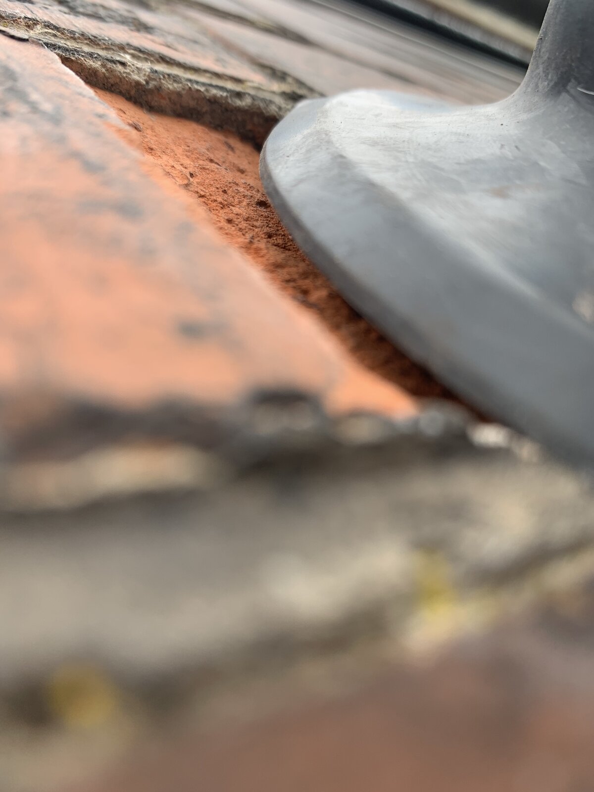

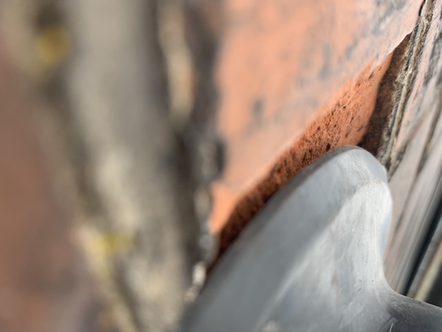

It’s not weather proof. you can feel cold air inside the house coming in.
I had a new boiler installed to keep the house heated not to ventilate through an incomplete job.

Less than a metre to the hole.
Less than that to the gas pipe.
He said it is a poor job. Defect issued to company for not following regs on weather sealing.
He said it is quite possible for the rain to get into the fluehole from what he has seen and cause damp issues. the same rain that comes down the render will just go into the hole.
That is why it MUST be weatherproof.
The render is roughcast which is traditional breathable render and is not designed to have warm steam impinging on it five hours a day in the winter.
You can see the paint blistering already on the gas pipe above it and you can see blistered pipe on the waste pipe none of this was there until this installation.

The seal should be adequate. Deemed inadequate.
I think you’ve got a lot of things on your mind.
I can see why you are not that happy with the flue sealing. You can see on the outside it leaves a slight gap around part of the circumference.. If the inside is the same, or the rubber not firm against internal plaster, it will cause draughts.
So to get that off your mind get someone, a builder or a friend or engineer, to mortar around the flue. Then that problem goes away. It sounds like you do not want to use the installer in any case.

first step though, get the flue sealed so that is off you mind.
I asked the original installer to do it but he failed to turn up.

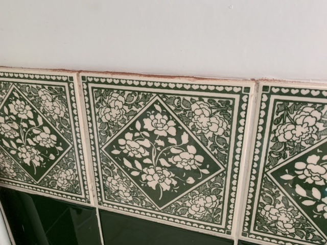

Every day I have to white brick dust up from the kitchen worksurfaces.
