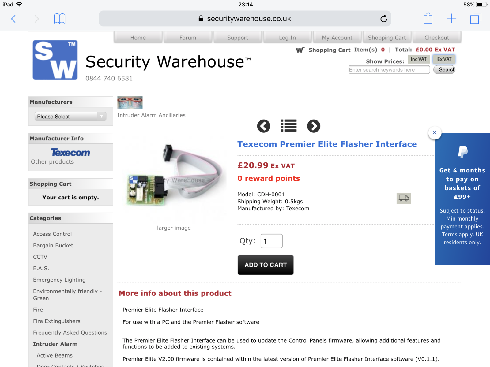

Hi, in order to install the above device, I need to upgrade the firmware. I bought the cable I thought was required, but can't work out how to do it. Can anyone direct me to any instructions for doing this please. I have downloaded the wintex software and would appreciate any guidance please?
Just google "flash upgrading texecom premier", first result is a pdf containing all the info you need to do it. Have you bought a flash upgrading kit or just a USB com? You'll need both.
Sorry, I put a few options on, can you confirm which one I need please?, appreciate your help.
